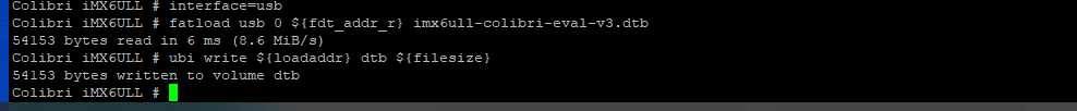

Hi there,
i did some wrong files updating the DTB on linux on command ubiupdatevol :frowning:
now the the modules does not boot anymore… Thanks for your Help!!
Florian
Error is:
ERROR: Did not find a cmdline Flattened Device Tree
i try to load a new dtb via uboot from usb stickt. But it does not fix it.

Hi there,
now it works :slight_smile: i had a type error in the registeradresses here:
ubi write ${loadaddr} dtb ${filesize} should be: ubi write ${fdt_addr_r} dtb ${filesize}
