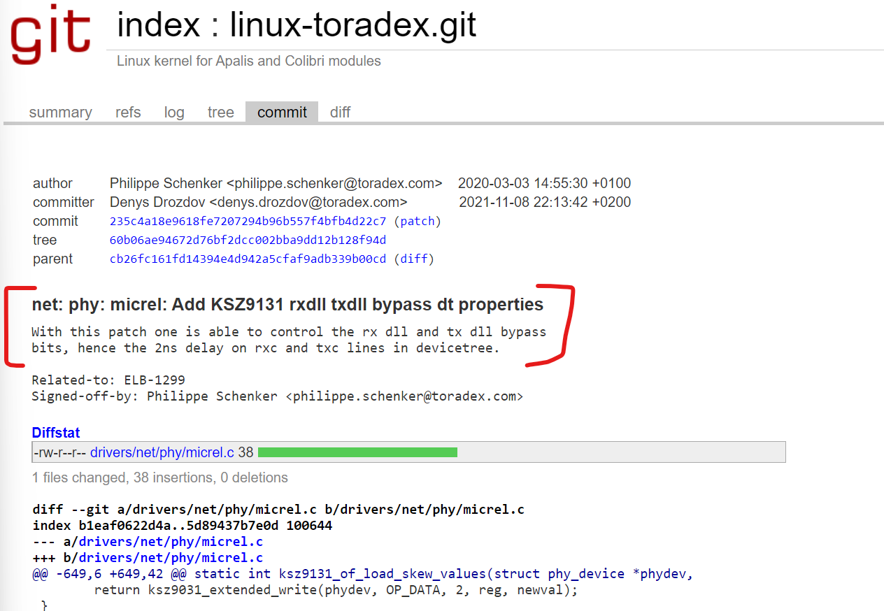

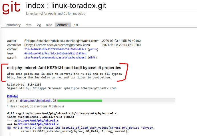

Could you let me know each patch’s purpose for supporting V1.1D Gigabit ethernet Transcevier?
K.Tomo
Hi @K.Tomo,
You can check the purpose under the log message of each patch. For example:
Unfortunately, there is no more details than that.
