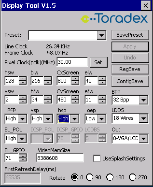

We are using WINCE 2013. I use different display preset from display tool with 800x480 resolution.
Hi @jayson , could you share your current setting from Display Tool? A screen capture of the Display Tool if you are using remote display.

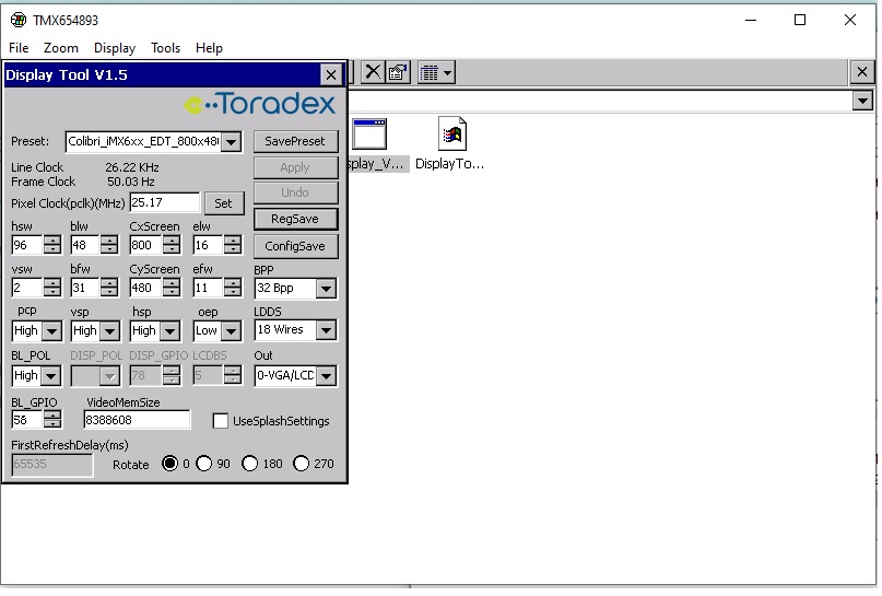

please try the following setting. The timing data comes from your LCD datasheet chapter 9.2. You can find each setting’s information here. You can adjust each one to make LCD working better.
Thank you. What is the ideal adjustment? What are the important parameter?
CxScreen and CyScreen are fixed. hsw, blw, elw, vsw, bfw and efw are adjustable as timing parameters.
