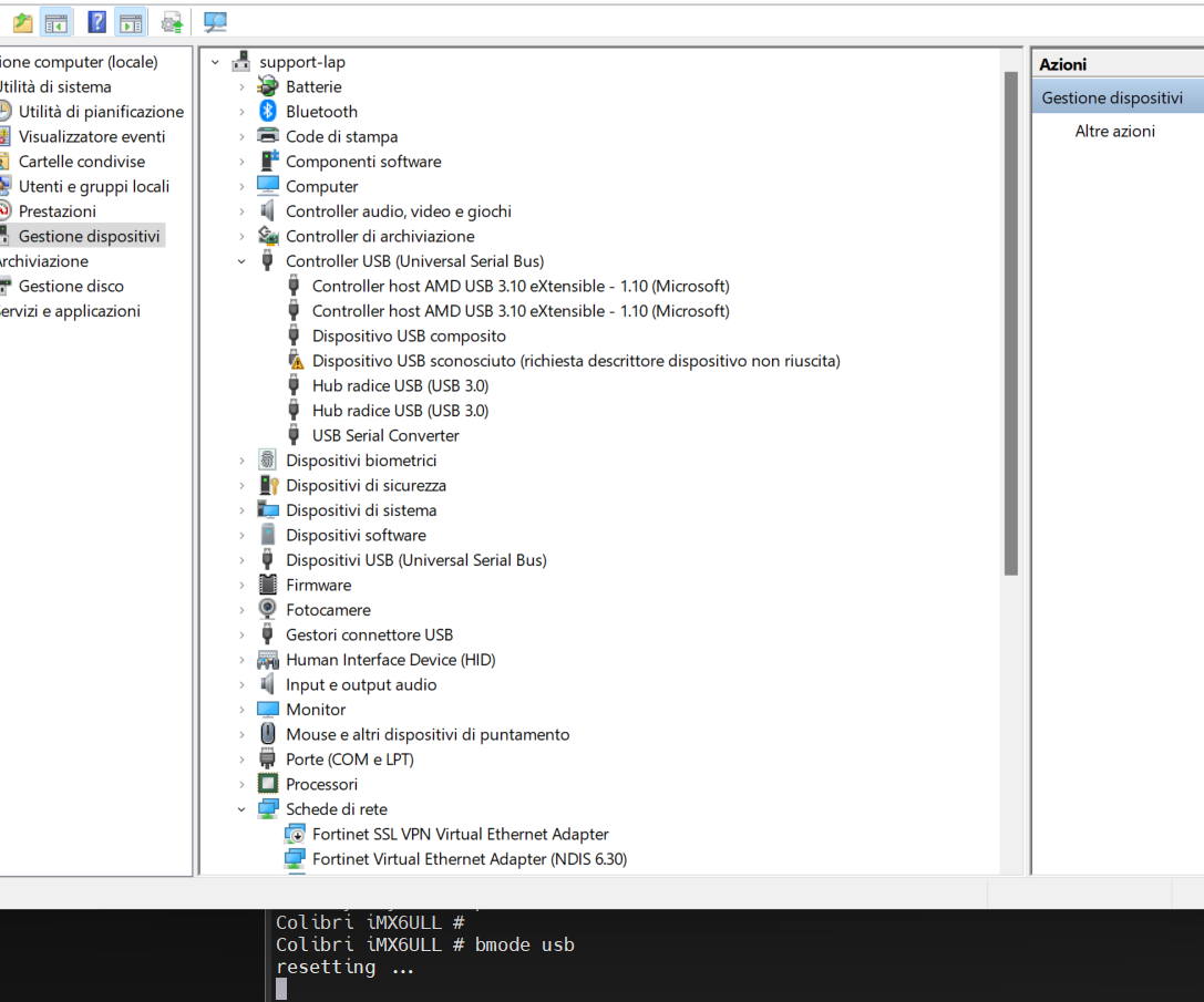

Using windows 11 the procedure doesn’t work because.
When link the usb OTG at pc nothing device are loaded and occours error when running file bat.

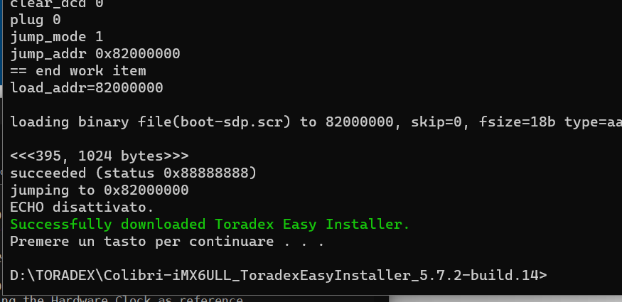

Yes I used Toradex Easy Installer 5.7.2+build.14 (see below).
Now i tried to link usb cable after “resetting…” string occurs.
When I heard the sound I started the “recovery_windows.bat” file and it’s work fine
I will try more times to check if it’s random or not.
