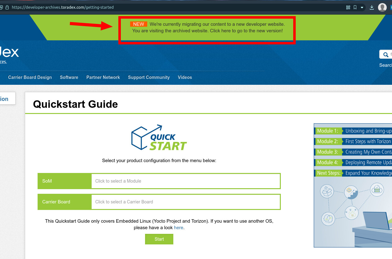

This Quick Start guide that you are using is from the Archived Toradex Developer pages, which are outdated. And the toolchain is not maintained anymore since BSP version 2.8.
For your case (BSP 5 and newer), you should refer to the current Toradex Developer: BSP Layers and Reference Images for Yocto Project | Toradex Developer Center.
Toradex does not maintain ready-to-use toolchains, so you need to follow the documentation and build the toolchain for your OS.

I suggest you to write on the web pages that the step by step guide that I followed, is obsolete. It is not immediately understandable the relation between BSP and Image.

Hi @Massimo !
The pages from the Archived Developer website (e.g. Quickstart Guide - Toradex) currently show the following banner at the top:
And by clicking on the banner, you are taken to the current Toradex Developer page (https://developer.toradex.com), where you can access the updated Toradex Developer articles.
