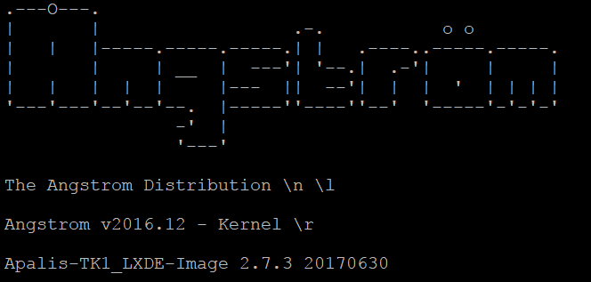

presently the image version we are using is
now with this image can i use the can or do i need to flash with recent version ?
Unfortunately that old beta version of yours is no longer supported and you would need to upgrade to either 2.7b5 or 2.8b1. As the CAN functionality is still being worked on you may also find a further optimised version to be installed via Toradex Easy Installer as e.g. mentioned here.
