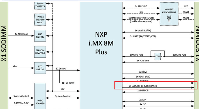

Hello, I have a few questions.
Regarding the i.MX8 Plus Verdin:
The block diagram shows ‘2xLVDS,’ but is it true that the i.MX8 Plus Verdin module does not have a direct LVDS interface?
Do I need a separate Mezzanine converter (or the Toradex DSI-LVDS adapter) to use LVDS?
Are there any other converter modules besides the Toradex DSI-LVDS adapter?
Even with a converter, is it not possible to use both LVDS interfaces?
Regarding the i.MX8 Plus SMARC:
Can I use both LVDS interfaces without a converter if I use the i.MX8 Plus SMARC module?
My goal is to control multiple LCD screens. (LVDS interface)

I misread the documents.
I should have checked the Verdin i.MX8 Plus datasheet,
but instead, I looked at the Verdin Family datasheet.
Anyway, does the Verdin i.MX8 Plus support an LVDS interface?
If so, does it have two LVDS channels that can output to different LCD screens?
Hi @Soonho ,
Both Verdin iMX8MP and SMARC iMX8MP have 2x native 4-channel LVDS exported on edge connector. They can support 2x single channel LVDS panels. What is the carrier board you have?
