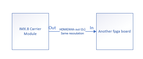

I am currently trying to use the HDMI Interface on the i.mx8qm without I2C.
We want to connect HDMI to the an fpga board and dont want to have I2C!!
May i know whether the Bypass I2c EDID for the HDMI I2c? I see that in the driver drivers/video/mxc_hdmi.c, there are a lot of configurations that is related to i2c communication.
By the way, I do not need to configure any setting on the HDMI display.
Thanks.

Could you please share a little bit more information about how you are setting up the system? Something like a schematic would be helpful.
Do you want always the same resolution?

I dont want connect HDMI display to a monitor!!
I want to connect it to a fpga(HDMI input),without i2c!!
exactly,i want always the same resoulation(like 1920*1080@30)!!
