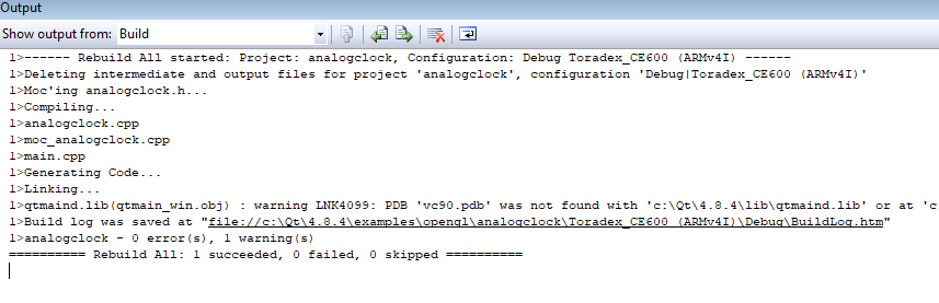

@Dim,
We are able to build the project without doing any change. Please see output window below. Are you getting the same output results?
do not compile
I solved the problem. it was necessary —> Change solution QT version.
