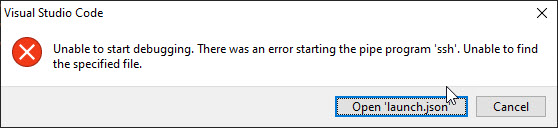

@eric.tx
This is what I get. There is no other information in the terminal, as it looks normal.
Steve
