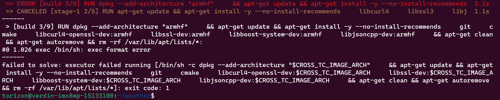

The probable cause for this error is that you are using armhf architecture. The verdin iMX8MP has an arm64 architecture
Josep
Hello Josep,
It work with both.
I tried to run the weather example using the command line of the Official Readme for arm64 architecture (docker-compose build --build-arg IMAGE_ARCH=linux/arm64 --build arg TOOLCHAIN_ARCH=aarch64 --build-arg CROSS_TC_IMAGE_ARCH=arm64) and I am still getting the same error.
Best,
Coline

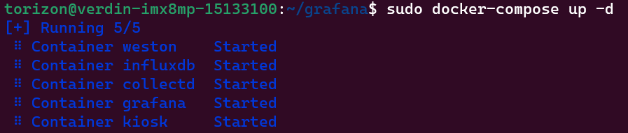

And for the grafana example, it seems to be running but only a black screen with a mouse open on the display. Do you have any idea where that could come from ?
