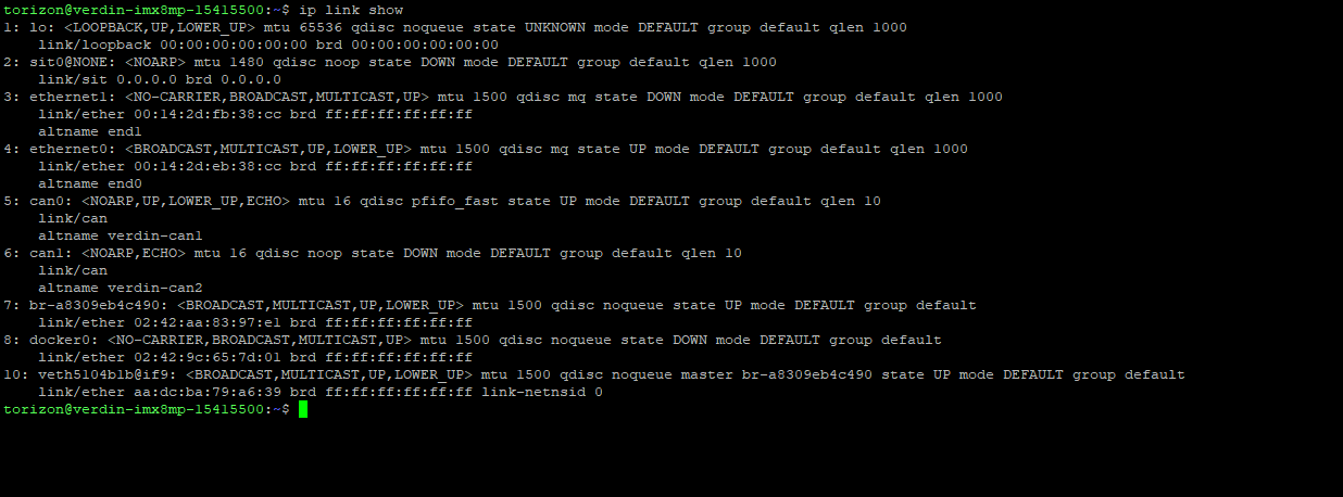

I am using verdin iMX8M Plus SOM.
Please find below image to see all available interface in my board
How to get eth1?
