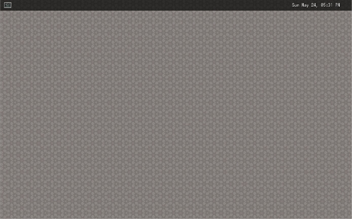

When I start the weston container to be able to use graphical application, I get the weston topbar:
docker run -e ACCEPT_FSL_EULA=1 -d --rm --name=weston --net=host --cap-add CAP_SYS_TTY_CONFIG \
-v /dev:/dev -v /tmp:/tmp -v /run/udev/:/run/udev/ \
--device-cgroup-rule='c 4:* rmw' --device-cgroup-rule='c 13:* rmw' \
--device-cgroup-rule='c 199:* rmw' --device-cgroup-rule='c 226:* rmw' \
torizon/weston-vivante:$CT_TAG_WESTON_VIVANTE --developer weston-launch \
--tty=/dev/tty7 --user=torizon
This is a bit annoying because when I launch a flutter application in fullscreen, this bar stays there. How can I remove it in Torizon? I know that you can change weston.ini to theoretically remove it but to do that I would need to modify the weston-vivante image, no?
