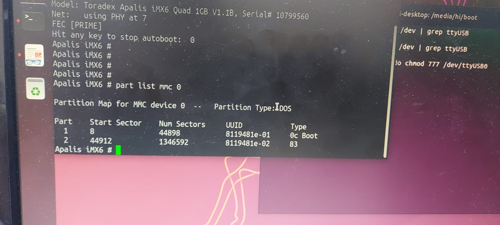

This was my partition table before.

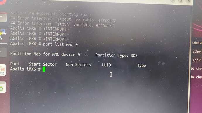

And that’s how it is now.

When you use Toradex Easy Installer to flash Toradex provided OS image or image built for using with Toradex Easy Installer - partitioning will be done automatically according to data provided by image.json file included in the image.
