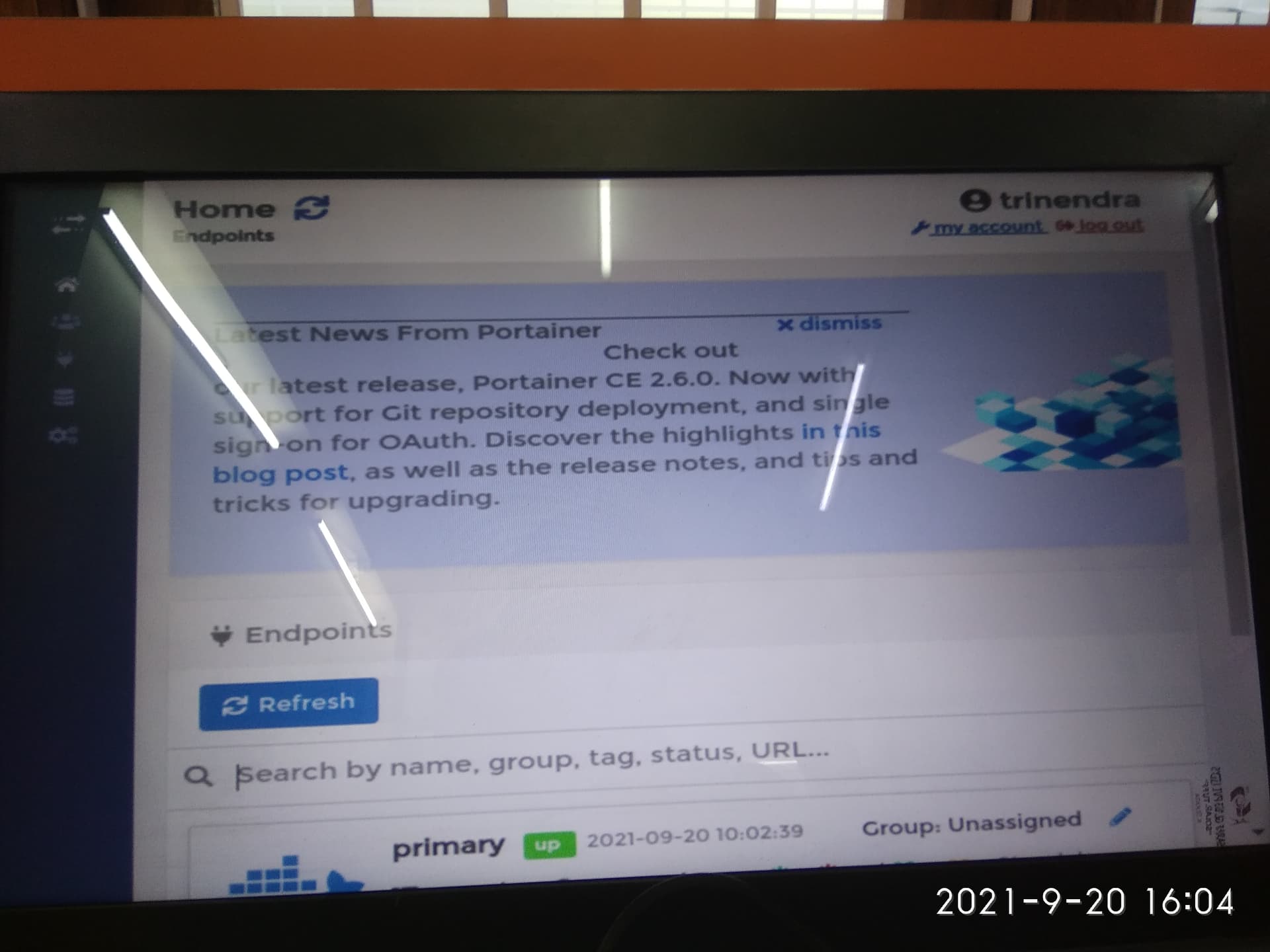

On monitor I am getting the screen like this .
can any one help me ?

To connect in local network the best is to use avahi and ping/connect by name. Avahi service should be enabled by default. Knowing colibri host name, which should be something like colibri_imx7 by default, you need to add .local suffix and ping/connect to from Windows 10/Ubuntu to colibri_imx7.local instead of unknown DHCP assigned IP.
Your serial terminal was misconfigured and now you are able to get the debug messages and also get the IP address.
