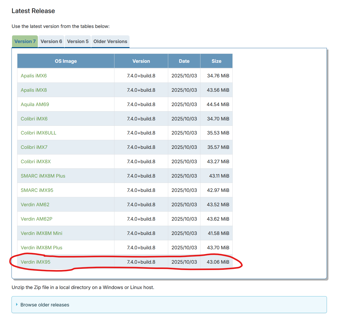

I just came across your post while trying to install Torizen myself. Do you really want to build Torizen yourself, or would it suffice to install pre-built images?
In case of the latter here is how it works:
  • Select and download the images from Download Toradex Easy Installer | Toradex Developer Center
  • Rename the file ending from .zip_ to .zip
  • Unzip everything
  • Format a SD card (I used the sd card formatter tool from sdcard.org)
  • Copy the individual files from the zip file to the root of the sdcard.
  • Insert the SD card into your Toradex carrier board
  • Connect a screen to the DSI→HDMI connector (not the HDMI port on the carrier board itself!)
  • Power on the board. It will boot to the graphical installer and you can install Torizon from there.
Note: The Toradex documentation also mentions other possibilities to get the Easy Installer on the board. Note that neither the USB flash drive method nor the uuu method worked on my board. The only working option is the SD card method.
Hope this helps.
Could you please confirm if there are any steps in the instructions at the link below that need to be adjusted for A1 silicon?
It should work fine for the A1 silicon I believe, my Verdin i.MX95 EVK is A silicon as well and these instructions worked for me in the past.
There is also this pre-built image available in this download link here: https://artifacts.toradex.com/artifactory/legacy-oe-prod-frankfurt/i.MX95_EVKImage-Torizon_OS_7.0.0/torizon-docker-imx95-19x19-verdin-7.0.0-devel-20250826231920%2Bbuild.0.wic.zst
Though this was built a few months ago, so the software on it is not the absolute latest. If you want the latest then you should build it via Yocto.
@doespaddel

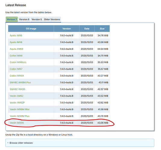

There’s no download link for the Verdin i.MX95 EVK on that page, and Toradex Easy Installer is not officially supported on this hardware either. Please don’t spread this misinformation and confuse other users.
@jeremias.tx
I’m pretty sure there is, maybe check again. I downloaded and installed it myself. There is a regular release version for the Verdin IMX95 (7.4.0+build.8 from 2025/10/03), and also a pre-release (7.5.0-devel-20251117+build.378 from 2025/11/17).

@doespaddel You are looking at the image for the Verdin i.MX95 this is not the same as the Verdin i.MX95 EVK. These are separate products with their own software:
