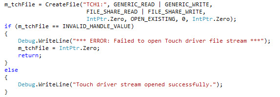

I am presuming that my app has to do some DeviceIoControl to get these events. So far I have successfully created the file like this:
Now I need to know how to do the opposite of IOCTL_SET_TOUCH_EVENT that the HW adapter does.
