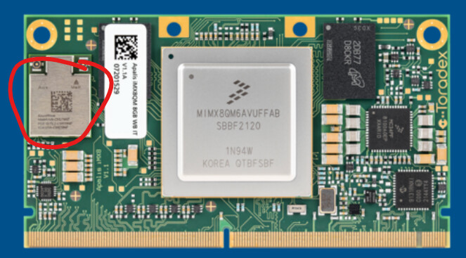

i’m working with the following configuration:
Apalis iMX8QM 4GB WB IT V1.1D
Ixora Carrier Board V 1.2A

i would like to improve it enabling Wifi Connection.
I can’t see wlan0 interface we I run ifconfig, and if I try to run connmanctl enable wifi I get the following error:
root@apalis-imx8-14759920:~# connmanctl enable wifi
wifi is not available
After that, trying to find a solution I alsa watched to the dmesg with the following result:
root@apalis-imx8-14759920:~# dmesg | grep wifi
