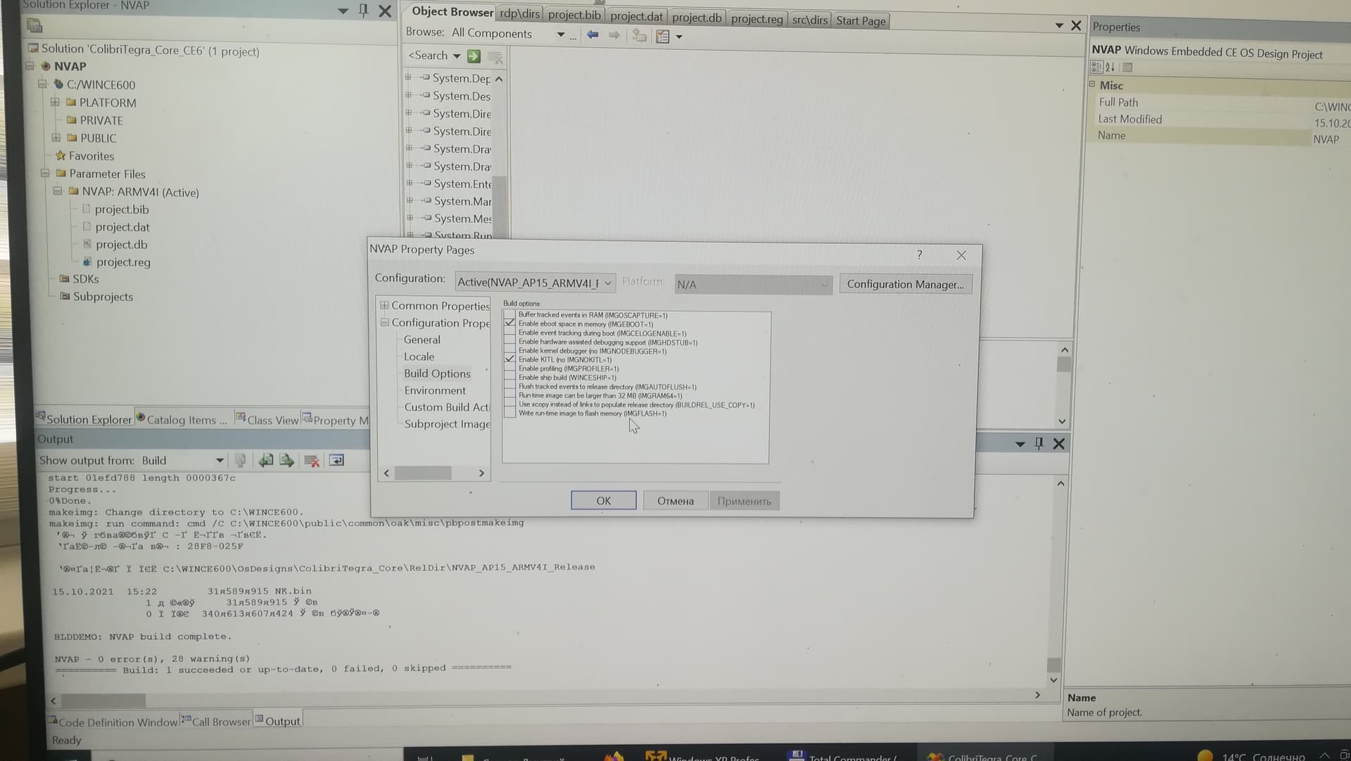

I’ve open the “C:\WINCE600\OsDesigns\ColibriTegra_Core\ColibriTegra_Core_CE6.pbxml” file project and save solution.
In Solution Explorer the NVAP platform in “PLATFORM” did not appear, but NVAP: in “Parameter Files” section does.
Project successfully compiled, but it seems , that destination project folder “C:\WINCE600\OsDesigns\ColibriTegra_Core\RelDir\NVAP_AP15_ARMV4I_Release” dont contain any specific Toradex files and configs except “platform.reg”.
File nk.nb0
successfully flashed by tegra nvflash utility. But fail to be loaded.
How create the NVAP platform? I don’t found any NVAP platform preference in project , does it mean that WINCE6.0 image created without Toradex BSP?

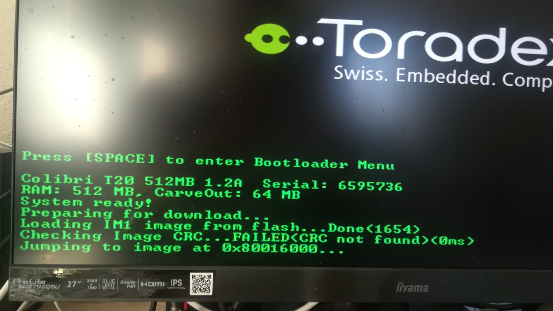

Hi Dmitry and Toradex Support team,
I came across your post because I had the exact same setup as you described in the question and encountered the same error message during boot (CRC not found). I don’t think it is due to KITL because it is the release build output (nk.nb0) being flashed into the T20 device through the update tool. Can you share some insight on how you tackle this issue?

There is a Tool in our Workspace that adds a CRC to the image as one of the last steps.. maybe this is not done in your built image?
Hi Germano,
Thanks for the response (sorry the notification was turned off for me). The image was booting but failed at the CRC checking step. Can you specify what the CRC tool is and I will check the build log to see if it is invoked correctly at the last step?

Hi @zlallen ,
The Tool is named AddCRC.exe and can be found in the ToradexFiles subfolder of the Workspace.
It’s called from PostMakeImg.bat (found in platform\nvap\files)
