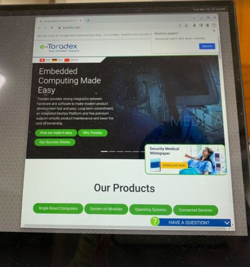

Hi @sjjin , the default guide is possible to add Chromium into the image and launch Chromium on Apalis iMX8 as the picture shows. Do you face any specific issue when controlling the device and monitoring?
@benjamin.tx Thank you for your answer.
I have confirmed the same functionality as above through chromium.

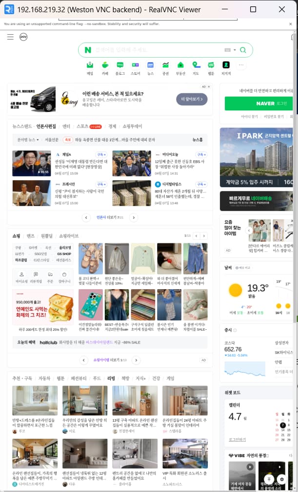

There was a problem with the VNC connection.
Keyboard and mouse control do not work when connected with VNC.
The following error occurs in chromium.
[2599:2599:0407/061328.977735:ERROR:cursor_loader.cc(116)] Failed to load a platform cursor of type kNull
Can you help me?
sjjin
Hi @sjjin , do you mean the keyboard and mouse connected to the target device don’t work on the remote VNC window opened on your PC?
@benjamin.tx Hi
There is no keyboard or mouse on the target device.
After connecting to VNC from the host PC, you cannot control the target device with the keyboard or mouse connected to the host.
sjjin
Hi @sjjin , is it still Linux BSP 7.2.0 when this issue occurs? Or is it TorizonOS, as you post in another ticket?
hi @benjamin.tx , The issue is with Linux BSP 7.2.0.
Hi @sjjin , I tested with RDP and found the same behaviors. It seems chromium has a bug to interpret additional input when using Wayland. There was a patch from this ticket. The same issue was also discussed on Chromium Community. However, I am not sure if this is still working on BSP 7.2.0. Is remote access(VNC/RDP) mandatory in your project? Or is it a way to make development easier?
