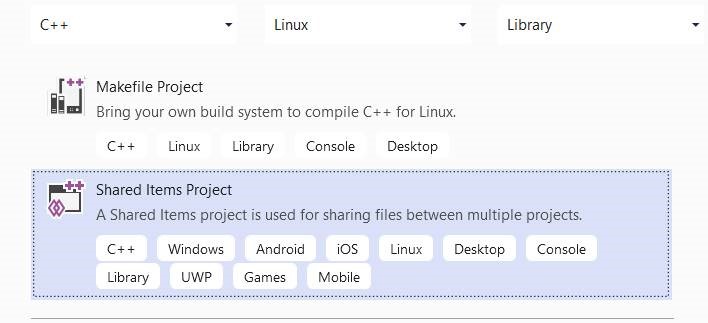

I use the VS 2019 IDE, I only see way to create library, after I put in the source, no button is enabled to build it. so no exename anywhere.
What I mean by the first step is create a Torizon C/C++ application. This is the only project template that is supported by our extension. If you create any other project template our extension will not work.
In this project copy and paste your shared library code into the main code body. This is what I mean by creating a project where the library code is your base.
