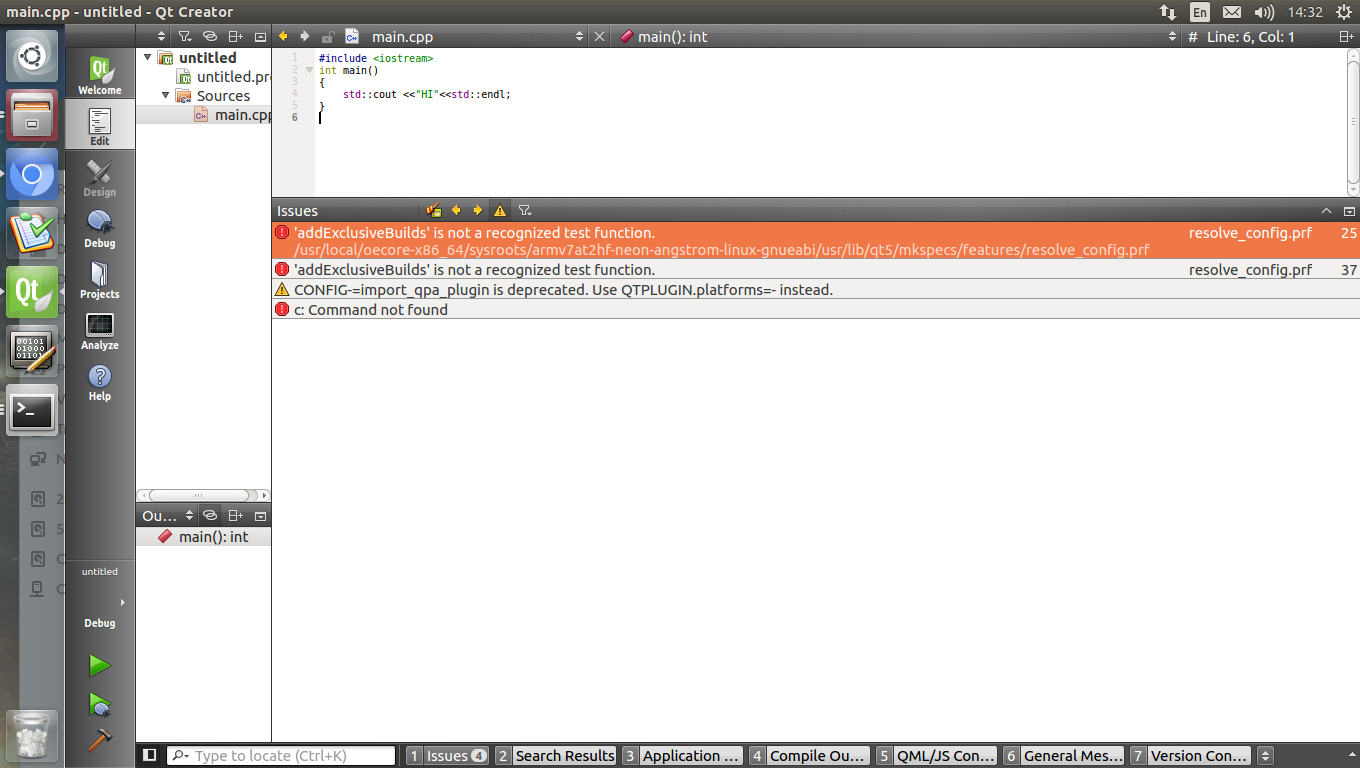

Thank you jaski, I was able to make SDK with qmake with your help, but now when I want to compile any of my projects, it has errors.
a simple prject which prints “Hi” has the following error:
thank you again for your help jaski. on the link you gave to me, he mentioned Qt version 4.9.0, but when I got to “Index of /archive/qt” there is no version 4.9 in Qt archive…
