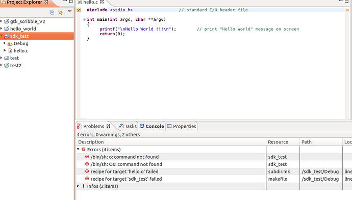

hi,
I was setting up Eclipse IDE , Usin OE Core SDK as per the following article
when I build the project I got the following error
Did you start eclipse IDE in the shell where you sourced the environment script ?
yes I did, still same error
I quickly rechecked using Eclipse IDE with oe-core SDK, it works as expected.
Can you please recheck your C/C++ build settings ?

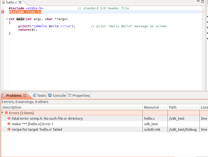

this is the new error found, may be the exported path issue, A ctually I was trying to access snmp.h file situated in
/usr/local/oecore-x86_64/sysroots/armv7at2hf-vfp-neon-angstrom-linux-gnueabi/usr/include/linux
I found it was part of meta-networking layer, path variable not included
“sysroots/armv7at2hf-vfp-neon-angstrom-linux-gnueabi/” folder and its sub directries,
The SDK which you build/use is for the standard evaluation Toradex image on which not all the packges which you are expecting are deployed. Ideally you will need to append your required packages to our the standard evaluation Toradex image recipe and build the SDK to that image so that the SDK will contain the libraries, headers & symbols of the packages selected in the image.
yes, it was an issue in addressing the header file, this was an irrelevant question,
or simply how van we add meta-networking layer headers in eclips includes
