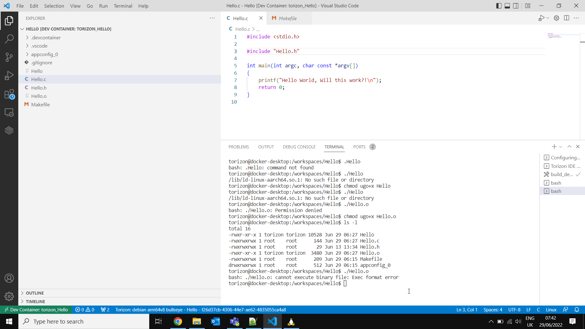

For the Hello.c program, clicking on Terminal → Run Build Task in VSCode generates 2 additional files as below.
  • Hello.o
    -Hello (without any extension)
I then click on New Terminal which takes me to the docker-desktop environment for this and try running the commands.
./Hello
./Hello.o
I have also used chmod ugo+x on both these files to make them executable.
However, I am getting errors.
For ./Hello
No such file or directory.
For ./Hello.o
cannot execute binary file: Exec format error.
Attaching a screenshot accordingly.
Please can you let me know why this option is not working. I need to compile more advanced programs using the Makefile option.

The error message is expected, because the SDK container that builds the application is actually x86_64: You can check this by running uname -r in a new terminal inside the container. It uses cross-compilation to build your project.
That’s why you’re seeing the exec format error when trying to run the Hello binary, which was built to run on Arm64 (the ISA for iMX8).
