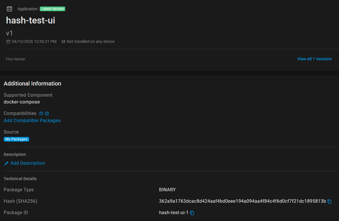

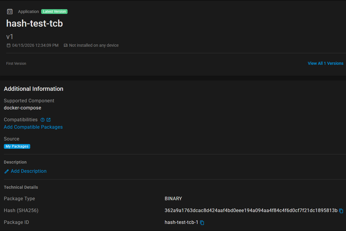

The hash for a file-based package (like docker-compose.yml) should be the sha256 hash of the uploaded file itself. The package name and version that you give it has no effect on this hash.
I confirmed this by uploading the same docker-compose.yml file both via TorizonCore Builder, and via the web UI methods. I used different package names in each case. The resulting hash for both methods resulted in the same hash for the package. Which makes sense since it was the same file that was uploaded.
