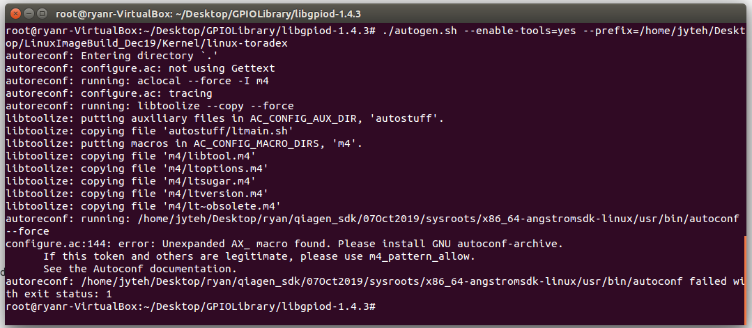

Hi Jaski
Is ther a how to guid to build the libgpiod?
I tried the steps in the README and i faced this error.
I tried both the 1.4.3 & 1.5.1 versions.
What did do wrong?
alt text
Hi
You need to install autoconf on your host.

Hi
I met another problem. Please find attached.
Regards
Teh Jingyang
You need to install the package autoconf-archive for your host.
