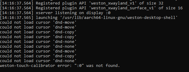

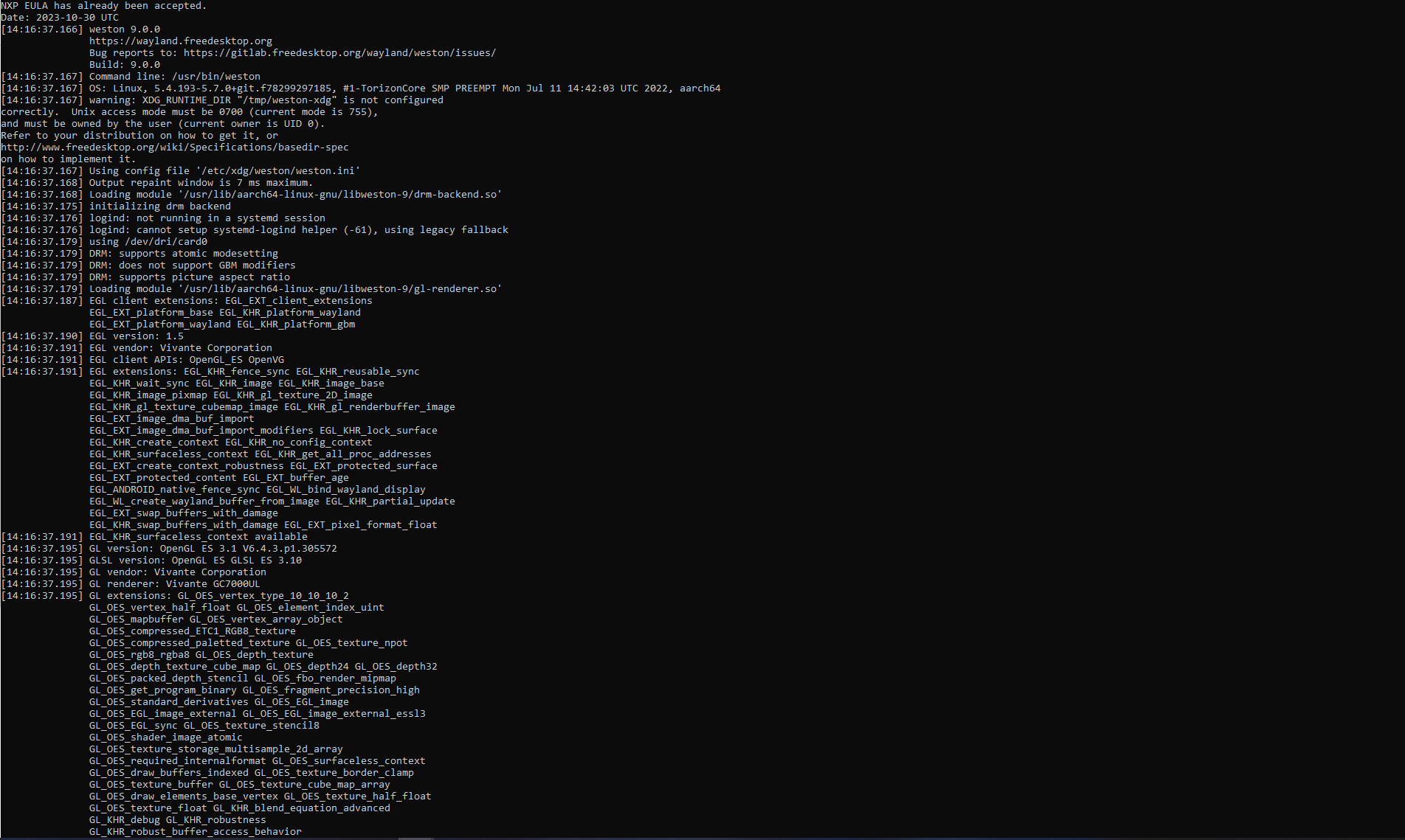

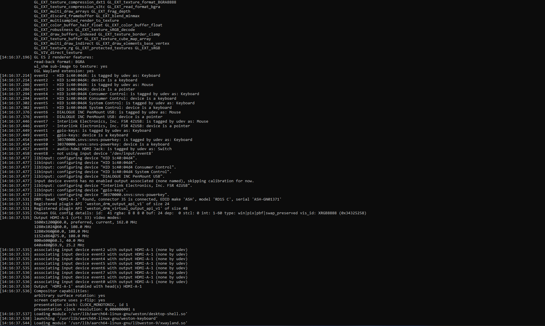

Getting "weston-touch-calibrator error: ":0" was not found" when I try to calibrate LCD resistive touch in weston container?
Hello world,
I’m working on calibrating LCD screen, using this link Touch Screen Calibration (Torizon) | Toradex Developer Center
when I try to run this
docker run -ti --rm --privileged -v /dev:/dev -v /run/udev/:/run/udev/ -v /etc/udev/rules.d:/etc/udev/rules.d torizon/weston-touch-calibrator:$CT_TAG_WESTON_TOUCH_CALIBRATOR
I get this error
