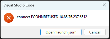

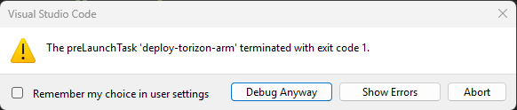

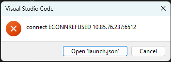

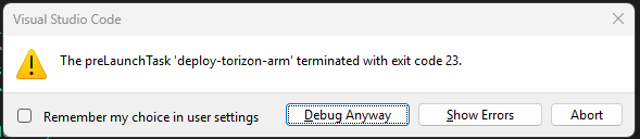

When I attempt to debug I get this popup error.
If I click debug anyway I get this popup.

This is what is displayed in the terminal when the error occur
s.
 *  Executing task: rsync -P -av -e ssh -p 6502 -o StrictHostKeyChecking=no -o UserKnownHostsFile=/dev/null /home/SAbrahamian/snmptoserial/src torizon@10.85.76.237:/home/torizon/snmptoserial/
Warning: Permanently added '[10.85.76.237]:6502' (ED25519) to the list of known hosts.
sending incremental file list
rsync: [generator] chgrp "/home/torizon/snmptoserial/src" failed: Operation not permitted (1)
src/
src/main.py
          8,597 100%    0.00kB/s    0:00:00 (xfr#1, to-chk=0/2)
rsync: [receiver] mkstemp "/home/torizon/snmptoserial/src/.main.py.1y8keC" failed: Permission denied (13)
sent 8,752 bytes  received 39 bytes  5,860.67 bytes/sec
total size is 8,597  speedup is 0.98
rsync error: some files/attrs were not transferred (see previous errors) (code 23) at main.c(1338) [sender=3.2.7]
 *  The terminal process "rsync '-P', '-av', '-e', 'ssh -p 6502 -o StrictHostKeyChecking=no -o UserKnownHostsFile=/dev/null', '/home/SAbrahamian/snmptoserial/src', 'torizon@10.85.76.237:/home/torizon/snmptoserial/'" terminated with exit code: 23.
The permissions for both main.py and SNMPTOSERIAL-MIB.py is 644.

 *  Executing task: DOCKER_HOST=10.85.76.237:2375 LOCAL_REGISTRY=10.85.76.210 TAG=arm GPU= DEBUG_SSH_PORT=6502 DEBUG_PORT1=6512 DEBUG_PORT2= DEBUG_PORT3= docker compose pull snmptoserial-debug
WARN[0000] The "DOCKER_LOGIN" variable is not set. Defaulting to a blank string.
[+] Pulling 1/1
 ✔ snmptoserial-debug Pulled                                                                                                                     0.2s
 *  Executing task: DOCKER_HOST=10.85.76.237:2375 LOCAL_REGISTRY=10.85.76.210 TAG=arm GPU= DEBUG_SSH_PORT=6502 DEBUG_PORT1=6512 DEBUG_PORT2= DEBUG_PORT3= docker compose -p torizon up -d snmptoserial-debug
[+] Running 1/1
 ✔ Container torizon-snmptoserial-debug-1  Started                                                                                               1.9s
 *  Executing task: ssh -o UserKnownHostsFile=/dev/null -o StrictHostKeyChecking=no -p 6502 torizon@10.85.76.237 pkill python3 || true
rsync: [generator] chgrp "/home/torizon/snmptoserial/src/main.py" failed: Operation not permitted (1)
src/
sent 115 bytes  received 23 bytes  276.00 bytes/sec
total size is 8,597  speedup is 62.30
This is no output on the debug pane.
The directory /home/torizon/snmptoserial was not created on the target.
The directory /home/SAbrahamian was not created on the target.
My directory structure on my development PC

Thank you for your detailed information and full logs.
Your rsync error is now:
This is a harmless warning unless your workflow depends on group ownership specifically. The files are syncing, but rsync cannot change the group to match the source. This is common with rootless users or containers.
Why this rsync warning occurs:
  • By default, rsync tries to preserve file group ownership (-a archive mode).
  • The torizon user on your target does not have permission to change file group (chgrp) on /home/torizon (unless the group is already torizon or you are root).
  • The discussion here is focused on application development, and you do not need to preserve group ownership for most user projects.
How to resolve or suppress this warning:
1. Ignore the warning (preferred if code syncs!)
If your files are in place (/home/torizon/snmptoserial/src/main.py exists and is owned by torizon), you can safely ignore this warning as it does not affect normal code deployment or debugging.
2. (Optional) Modify rsync behavior in your VS Code tasks (if possible)
You can add the --no-group option to the rsync command (removes group preservation):
rsync -P -av --no-group ...
With Torizon Core IDE extension, this is not user-configurable and would require the extension to support it.
3. Clean up any root-owned files (so group changes are never required)
Double-check:
sudo chown -R torizon:torizon /home/torizon
If /home/torizon/snmptoserial doesn’t exist, let the VS Code extension create it.

This points to a mismatch between your VS Code workspace root and what the Torizon IDE extension expects for project structure and deployment.
Steps to Resolve
1. Ensure VS Code Is Opened in the Correct Workspace
Open your project in VS Code by opening the folder that contains your .vscode directory (e.g., the snmptoserial folder itself), not a parent or subdirectory.
VS Code should display snmptoserial as the “opened folder” in the Explorer pane.

I did open VS Code through WSL.exe using code .
My workspace is the /home/SAbrahamian/snmptoserial folder.
Where do I find the settings for source and destination sync paths to ensure that they match?

For some reason my workspace was looking at /home/SAbrahamian/ instead of /home/SAbrahamian/snmptoserial/
I fixed this by selecting the folder /home/SAbrahamian/snmptoserial/ folder after clicking File>Open File. I then saved the workspace by clicking File>Save Workspace As and saved that file in my /home/SAbrahamian/snmptoserial/ folder.
I am able to debug again!

I made the changes to launch.json, settings.json, and docker-compose.yml. But I am still getting an error popup that says preLaunchTask ‘deploy-torizon-arm’ terminated with exit code 1.
Clicking “debug anyway” yields another popup that says “connect ECONNREFUSED 10.85.76.237:6512” and prompts me to open launch.json
How do I fix this error?

Hello! Let’s address the new errors you’re seeing:
1. preLaunchTask ‘deploy-torizon-arm’ terminated with exit code 1
This generally means something failed during the deployment task. The most common reasons are:
  • Docker Compose is not able to cleanly start/stop containers.
  • Networking to the device is blocked or unstable.
  • Required debug ports are not open or mapped in docker-compose.yml.
  • Previous containers/files are interfering with new deployment.
2. connect ECONNREFUSED 10.85.76.237:6512
This indicates that the Visual Studio Code extension on your PC can’t reach the debug server on the target device at port 6512. Root causes can include:
  • The debug container is not running or crashed.
  • The required port mapping is missing.
  • A firewall or network issue is blocking the port.
What To Do
A. Verify docker-compose.yml Has All Required Port Mappings
Open your docker-compose.yml and ensure your debug service includes:
ports:
  - "6502:6502"
  - "6512:6512"
Reference:
B. Check the Debug Container Status on Your Device
SSH into the device and run:
docker ps
You should see your debug container running, with both ports (6502 and 6512) exposed.
C. Clean Up Any Orphaned Containers
Still via SSH, run:
docker compose -p torizon stop
docker compose -p torizon rm -f
D. Ensure No Other Process Is Using Port 6512
On your device:
netstat -tuln | grep 6512
You should see docker-proxy or similar. If nothing is shown or a different process is bound, this may be the cause.
E. Check launch.json for Port Consistency
In your .vscode/launch.json, verify the debug configuration uses exactly port 6512 and not another value.
Reference:
F. Restart & Retry Debugging
  • Stop all VS Code/IDE tasks.
  • Make sure containers are stopped and removed.
  • Start debugging again from scratch.
G. If problems persist
Please share:
  • The output of docker ps on your target.
  • The relevant parts of your docker-compose.yml and .vscode/launch.json.
  • Any new error console logs.
Let me know what you find from these steps, and we can proceed based on your results.
