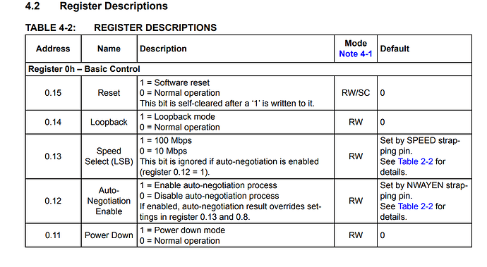

Well, currently we are using Colibri VF61, this SOM uses the PHY KSZ8041TL.
In the datasheet of the PHY i can see this IC has some registers such as image belows:
This is the register 0 of the PHY, so the question is, can i, by using NDIS driver, acces to this register and set or clean the bits in?
In linux i can use phytool that do exactly what i say…

Hi @RIki89d ,
OK, i think i remember we discussed this already in the past.
There is unfortunately no way you can do this with the current network driver or NDIS interface.
The easiest would be if i add this functionality to the network driver and expose some APIs you can call to read/write the PHY registers.
I could add this, but i would have to charge some support hours. I estimate 8 hours are enough. Check:
