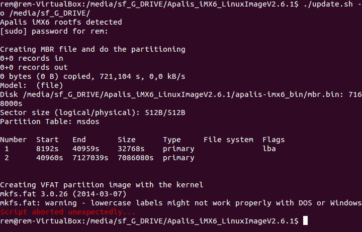

After this I followed the steps that are described here: Flashing Embedded Linux to iMX6 Modules. But when I try to run the ./update.sh command, I run into an error. The error is that the script aborted unexpectedly:
Does any one of you know if this is a problem with the Virtualbox program version, Linux OS version or the update.sh file itself? I already tried different way for the last two days, but it seems that I don’t getting to work with me.
I think I spotted the issue now. You are supposed to extract the BSP demo image package somewhere on your harddrive rather then already onto the update media being e.g. the USB stick or SD card. Only during the second step when executing our update script you are supposed to give it the path to the update media e.g.:
cd
sudo tar xjvf Apalis_iMX6_LinuxImageV2.7Beta1_20170112.tar.bz2
cd Apalis_iMX6_LinuxImageV2.7
./update.sh -o /media/sf_G_DRIVE
