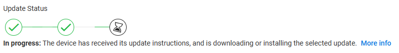

That information is not shown in the “More details” view:
so I can only see which was the package installed BEFORE the update.
Do you know how I can find the target package name and version when the update is requested but not finished (so “pending” or “in progress”)?

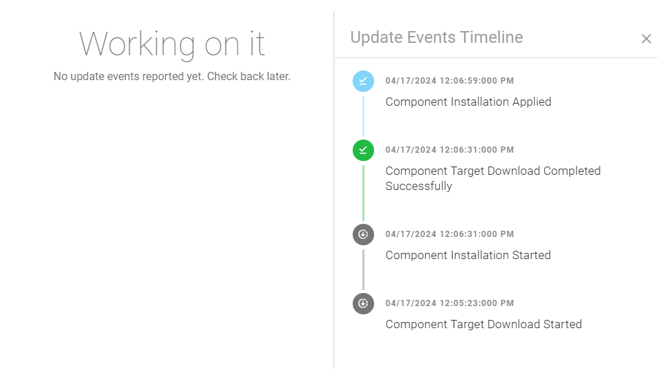

When an update is “Pending”, the “More info” button actually shows the update which was requested.
The problem as you reported happens when the update is “In Progress”, in this state the package information is not shown.
Unfortunately there is no easy way to see this information right now.
I will check if there is a workaround and bring this to the Torizon Cloud team.
I’ve put something in our backlog to get this displayed in the UI, because I think that’s a pretty reasonable request. To get the info you need right away, though, there’s a workaround you can use: you can get this information by directly calling an undocumented internal API endpoint that the UI uses (for example, with curl). Something like this should work:
