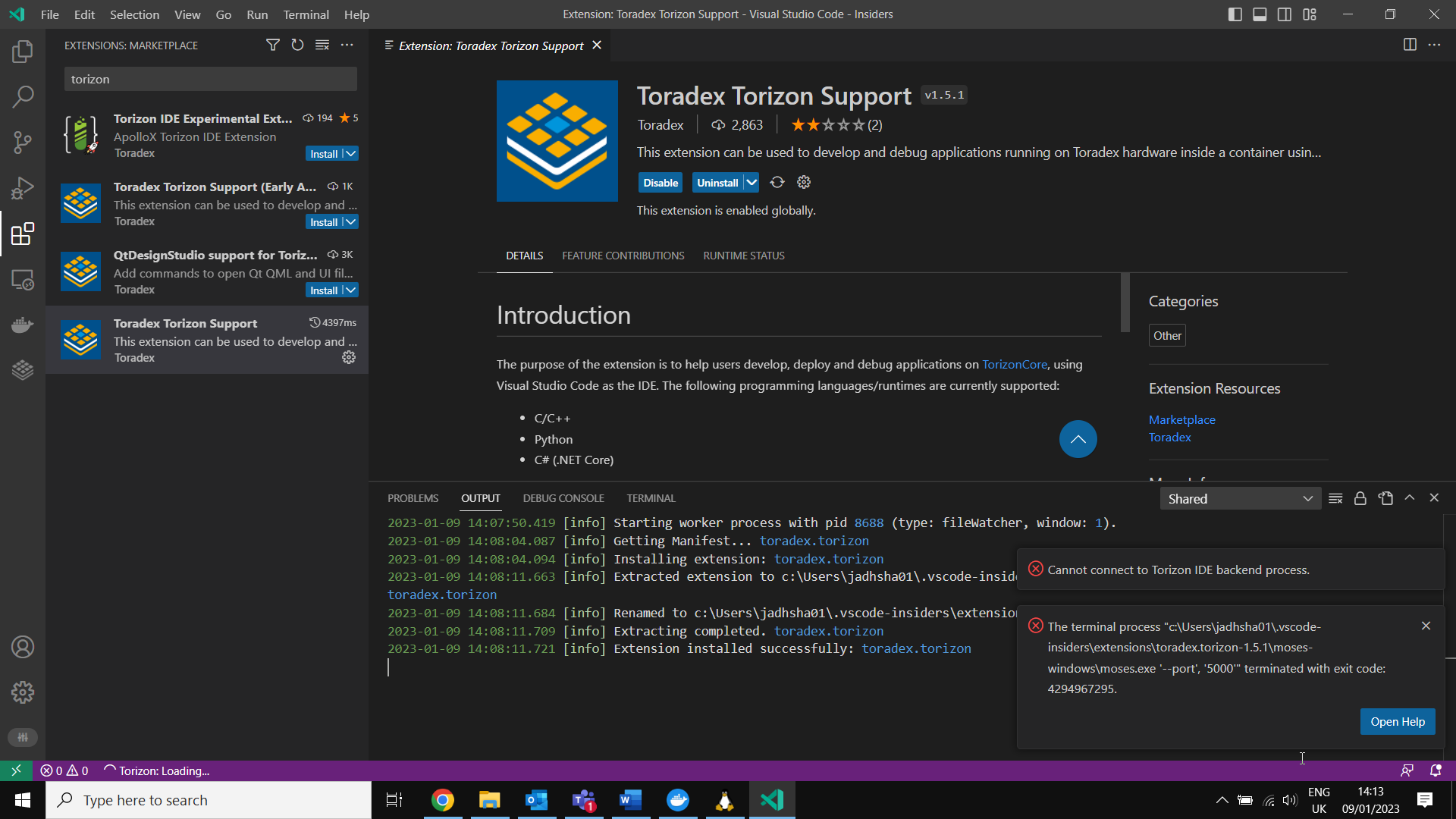

I am getting an error when trying to install toradex torizon support extension on VSCode - Insiders and VScode.
The terminal process “c:\Users\user-directory.vscode-insiders\extensions\toradex.torizon-1.5.1\moses-windows\moses.exe ‘–port’, ‘5000’” terminated with exit code: 4294967295.

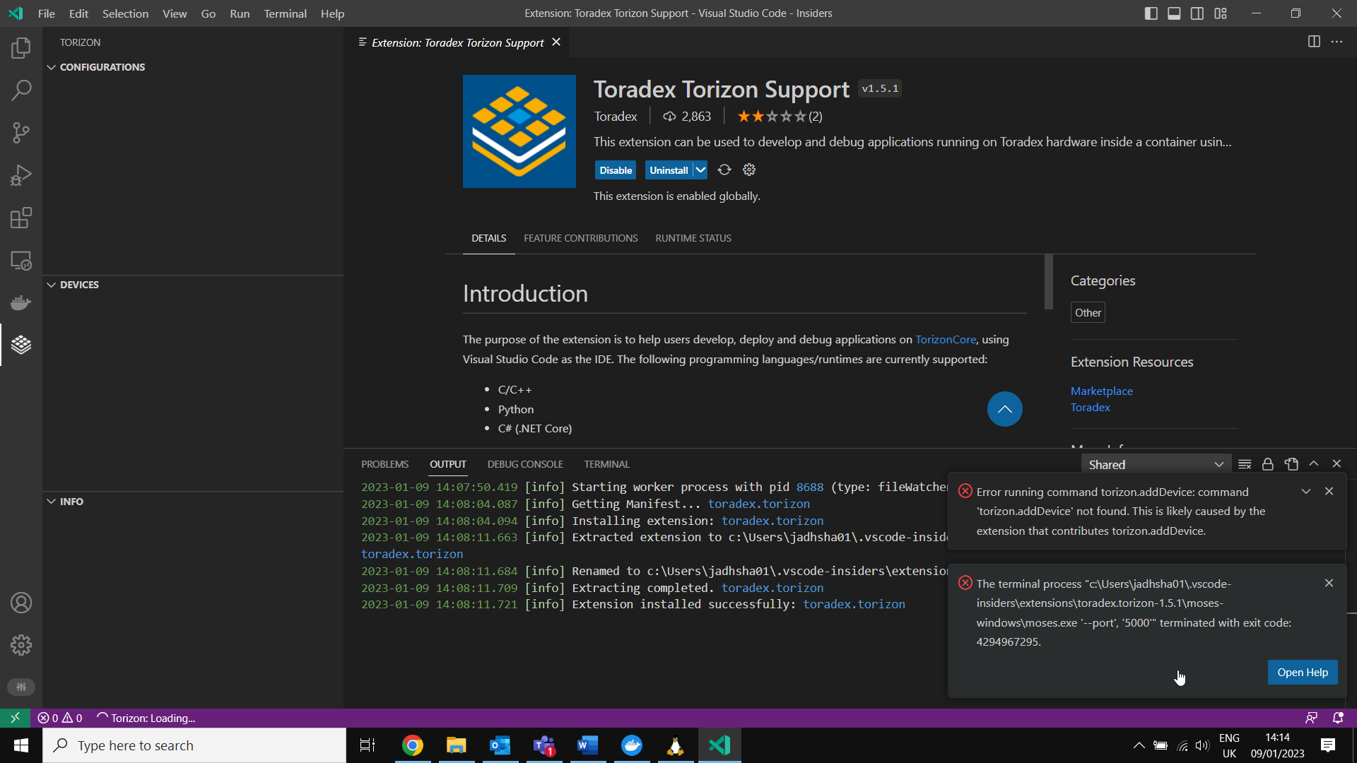

This does not allow me to add any devices in the Torizon extension. Please can you check this.
See attachments for further details.
It appears to be linked to the latest version of Docker desktop installed but cannot confirm this.

If you check the first screenshot, it tells that add device command not found. Issue likely caused by extension that contributes torizon.addDevice.
