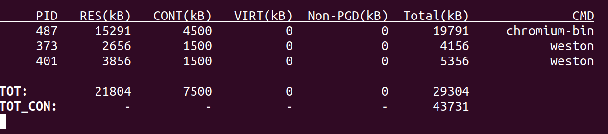

I am using gputop for finding the usage of RAM by GPU. I have downloaded gputop from gputop
I got the following result.
I confused with TOT and TOT_CON. I have check the function for calculation of both. I found that TOT_CON is remaining CMA memory from allocated CMA to GPU (allocated CMA - RES(KB)). but it is not matched with TOTAL or TOT.
Here, I have doubt that CONT(kB) is part of reserved.
Could some one explain this and gputop?
