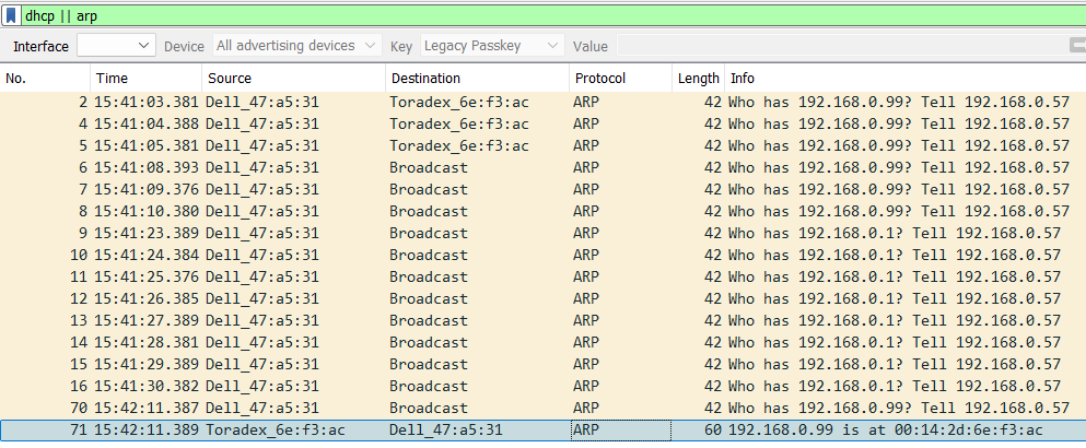

The EThernet interface eth0 almost takes 60 to 80 seconds, after the board is powered on, to respond(ARP Reply) to a PING request from host PC. The eth0 is configured to use static IP address settings using the ‘connman’ service app(not using systemd-networkd) to make sure DHCP Client is not active.
The board takes around 35 to 40 seconds to boot into the login prompt in the serial terminal as shown in the log below:

The Ethernet traffic capture in Wireshark:
The ‘ARP Reply’ packet comes at 15:42:11, almost 70 seconds after power cycling.

As suggested by the Toradex AI Assistant we built a new Console image(Colibri-iMX7_Reference-Minimal-Image) with connman package(connman, connman-client etc.) removed.
So tested the Ethernet eth0 activation delay(ARP Reply) using only the systemd-networkd and a wired.network file with static IP address settings in the /etc/systemd/network .
But we still see the same problem. The board, after power cycling, takes around 35 seconds to boot completely and the PING reply from the eth0 network interface takes around 70 to 80 seconds.
Also, because there is no ARP Announcement other devices in the network are not able to update their respective ARP cache as soon as possible.
As suggested by AI Assistant we added a systemd service, that is triggered by ‘network online’ (CORRECT: Wants=network.target , After=network.target; WRONG: After=network-online.target), which runs a script containing ‘arping‘ command. Works fine..
