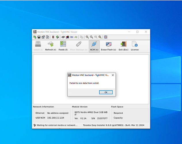

after the installation of images it will display the error like “failed to recv data from socket” for better understanding i have share the screenshot of that error

Regarding the screenshot , it is trying to fetch image list from Toradex server and since there is no IP assigned, its showing this error.
You need to connect LAN cable (ethernet) to your board.

i am not installing images online i am install image offline using pendrive after the image is successfully it will shows the above screenshot error.

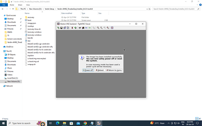

after installing images it will shows the below screen.+
after showing on this screen i am trying to power off or reboot it shows above error.
and i am also try to connect with internet via ethernet cable but it is still showing no address assigned.
how can i assign the address and after installing images how can i go for further process

You can not connect the to the module via VNC after installing image because there is no VNC server running on the image. There is no error on that.

i have connected the module via VNC only after that i am installing image successfully if i am not connected with VNC than it will not install images not show the power off screen so tell me how can i achive that
