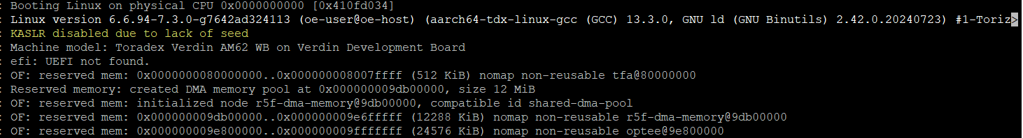

The issue you’re experiencing with ETH2 not being available is likely related to the device tree configuration. The mismatch between the U-Boot detection (“Verdin Development Board”) and your actual hardware (Ivy Carrier Board) indicates that the system is loading the wrong device tree.

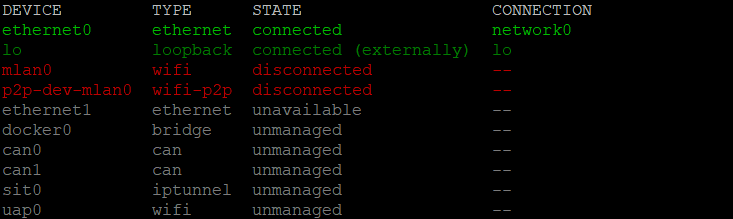

Torizon OS uses NetworkManager for network configuration, and Ethernet interfaces are named ethernet0
, ethernet1
, etc. (3). You can check the status of your network devices with:
# nmcli device
(3)
To show available connections and devices:
# nmcli connection show

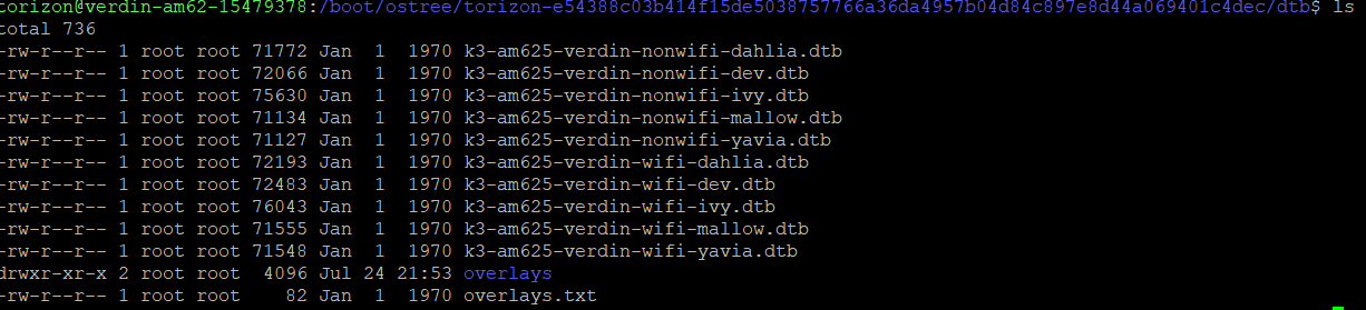

Check Available Overlays: Look for Ivy-specific device tree overlays in the /boot/ostree/tori.../dtb/
directory.
Apply Correct Device Tree: You may need to use TorizonCore Builder to create a custom image with the appropriate device tree configuration for the Ivy Carrier Board.
Network Interface Configuration: Once the correct device tree is loaded, configure both Ethernet interfaces using NetworkManager commands (3).
The key is ensuring that the system loads the device tree configuration specific to your Ivy Carrier Board rather than the default Verdin Development Board configuration.
