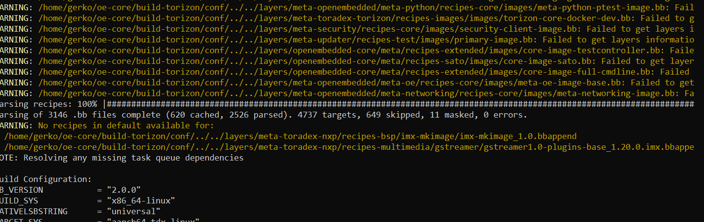

I started a new bitbake with modifications via a new layer (adding 2 patches).
There are a lot of warnings coming now…we’ll see
Well, all I can say is welcome to being a Yocto developer. It has a high learning curve for a reason. But I’m sure with more time and experience you can get the hang of it. If you have any future questions feel free to ask us. Though, keep in mind it can be a bit difficult for us to debug a custom Yocto build on your side, but we’ll always do what we can within reason.
