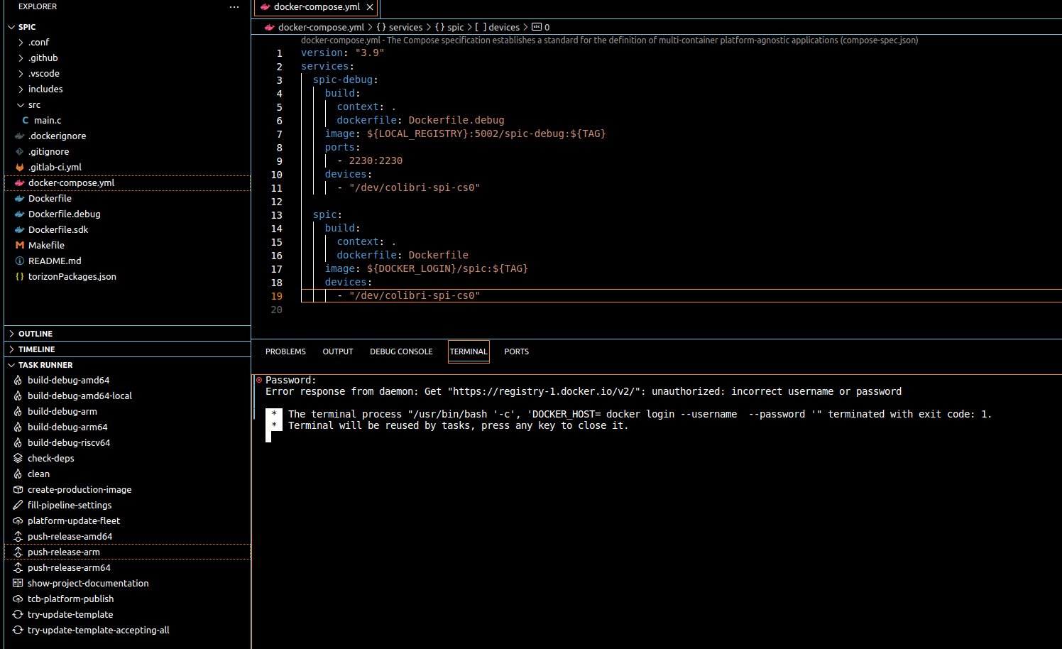

I wanted to run the SPI sample code from https://github.com/toradex/torizon-samples/tree/bookworm-new/spi/C/spiC.
I have build the program, but I am unable to push the code and deploy. It asks for some password and if I enter Docker hub password, it fails. Please guide how to use SPI bus in Toradex.

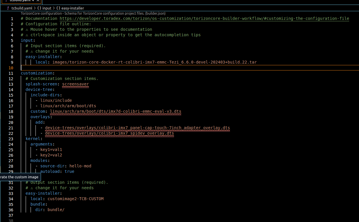

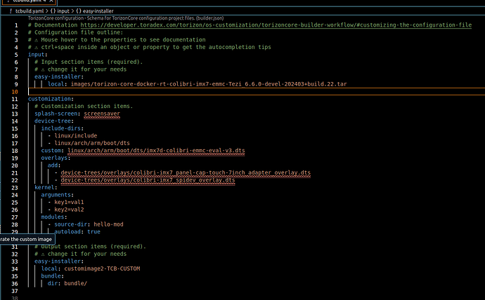

I used the TorizonCore builder to apply overlay.
OS: Torizon 6.6.0 with PREEMPT_RT patch, as can be seen in the screenshot below.

Regarding your issue, can you please also confirm are you able to use your docker login outside vs code?
Additionally also let us know do you want to push your image to docker or you are trying to deploy application container to module, if you waant to deploy to module then you need to select Run and Debug (Ctl + Shift+D) → select Torizon ARMv7 and this should deploy the container to module.
If you still face issue please share complete logs in text format to further check.
