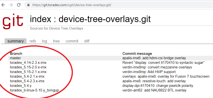

it says to clone a directory but add in the correct branch name. However, when I go to the repository, there are no branches here. It appears that this is broken here.
I mean yes, did you see the documentation I referenced in my previous post? There’s a section in there about how one could incorporate kernel and device tree related changes. It outlines a simple example though, so you may still need to reference Yocto documentation for more complex scenarios.
Hi @alex.tx,
Yes, if I use your cgit link, I can see the branches. However, if I use the straight git link:
Index of /device-tree-overlays.git (toradex.com),
and I click on branches, nothing shows there.
