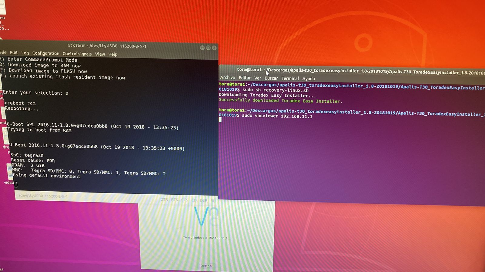

I’m trying to migrate from wince to yocto, but I can’t load the easy installer.
does not show the image on the monitor and neither does the vnc

Hi @AlanM,
it appears the Toradex Easy Installer wasn’t correctly loaded to your module. Could you please check if you’ve followed all the steps in this guide?
You need to put your module into recovery mode to run the Toradex Easy Installer.

Hello, I have followed the tutorial, and in the image on the left you can see that the tezi was uploaded correctly
“successfully downloaded toradex easy installer.”
Thank you very much, I was able to solve it.
