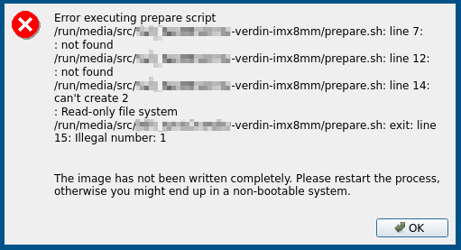

"Error executing prepare script" when installing Tezi Image

These are the contents of prepare.sh (line numbers added by me):

It almost seems like it’s not using bash to execute the script, since it throws errors about whitespace and argument references.
We were able to successfully install the image by removing all extra whitespace lines and by commenting out the error_exit function. Extra whitespace also had to be removed from wrapup.sh
However, this image still does not boot, which means that the root cause of these scripts behaving weirdly might still be buried somewhere else. I will leave another comment if we come across anything that seems relevant.

This ended up being two dumb issues. Because I am building the image on a Linux server that is essentially offline, I am forced to download dependencies like the meta-mender-community layer on my local machine and scp them over to the build server. Because Windows likes to screw with whitespace, I tried to be as diligent as I could to use WSL and MINGW when handling these files, but somehow the whitespace of the Mender layer files still got screwed up (classic nl → cr nl issue). Fixing the whitespace resolves the script errors.
The non-bootable image was due to a hard-coded .dtb file in the local.conf.append files provided by Mender (the instructions have you append these lines to your image’s local.conf), which attempted to load a .dtb that didn’t exist.
