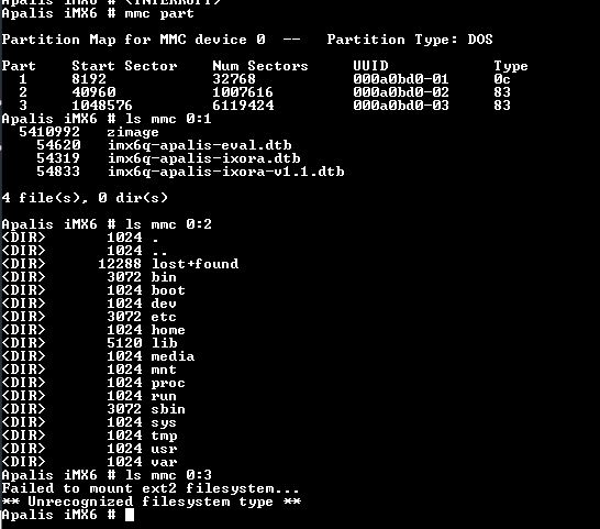

Hi Team,
We are trying to create a extra partition for the emmc for firmware update. We have made some changes in the update.sh file. Fortunately, we were able to create the extra partition(3rd partition), but when we try to access the partition using command " ls mmc 0:3 " , we get :
Failed to mount ext2 filesystem…
** Unrecognized filesystem type **
Could you please suggest how to fix this?
Please find the screenshot and the modified update.sh filelink text

Hi Surajeet
Thanks for the file. You need also to change the u-boot script as described here.
Jaski

Hi
You need to change in which partition you want to write Rootfs. Did you follow the instructions described in the link above?

I have made the changes in the u-boot script and was able to populate third partition with rootfs successfully. Does ${drive}:1 refer to the partitions of the emmc. And what changes should I make so that I can use the rootfs from the third partition (mmc 0:3)? Please suggest…
