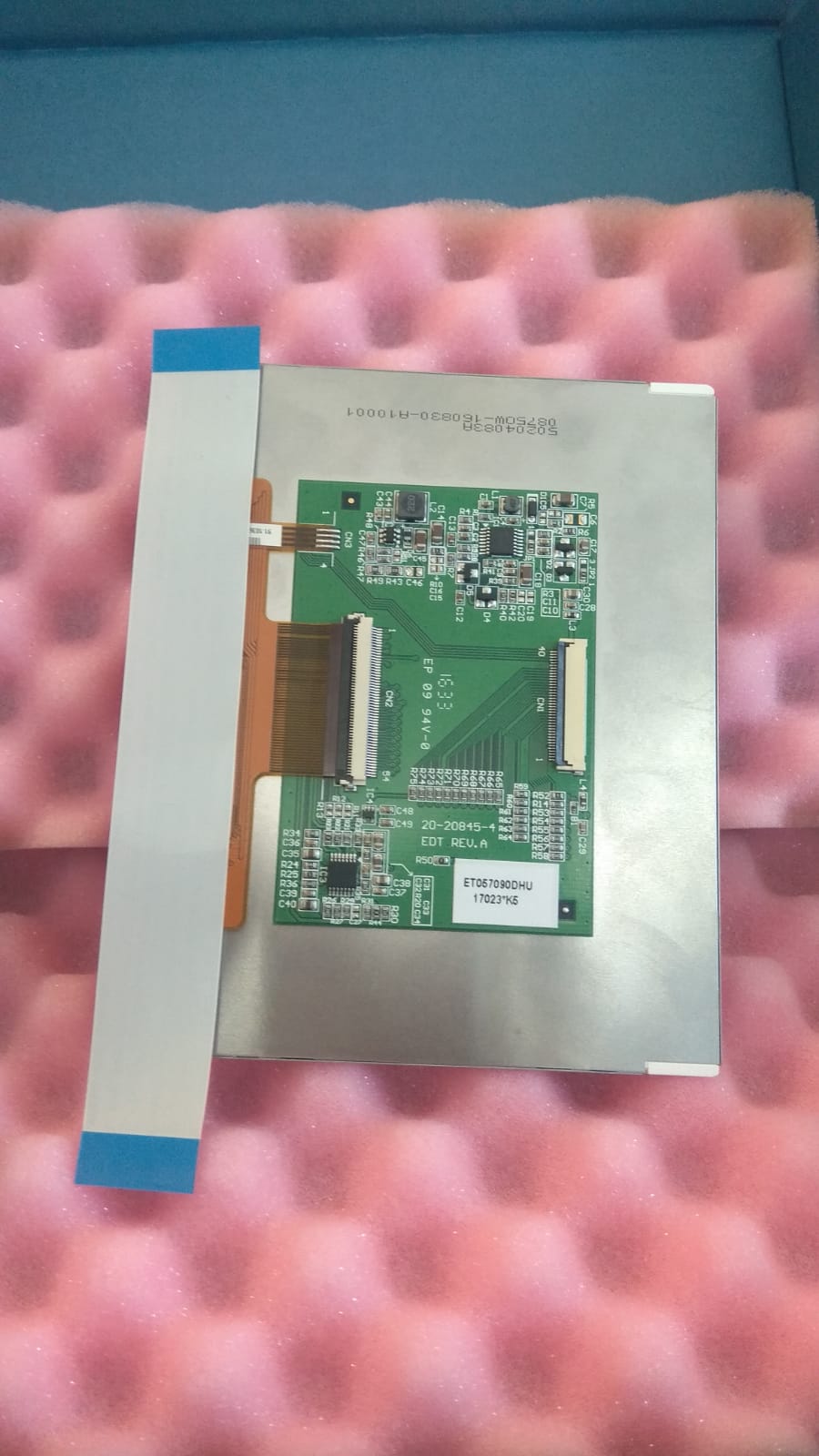

I am user of Apalis IMX6 and i tried to work with EDT 5.7" TFT VGA Touch screen. I have a carrier board called as Ixora V1.0A and using as master Apalis IMX6D 1GB IT V1.1B. It have Linux Reference Multimedia Image 5.3.0.
I have readed some articles;
and that screen’s datasheet.
I couldn’t make a clear sense
Then I tried some commands as;
setenv vidargs ‘video=mxcfb1:dev=lcd,800x600M@60,if=RGB24’
setenv vidargs ‘video=mxcfb0:dev=lcd,EDT-WVGA,if=RGB24’
then when i boot that device “dmesg | grep fb” output were nothing.
How can i use this screen as touchable and with customizable resolutions?
