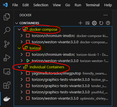

Torizon IDE Extension (ApolloX) + Docker extension show the containers running on the devices, grouped in a way similar to the following image:
Is there a way to edit the docker-compose.yml on the device from here?
