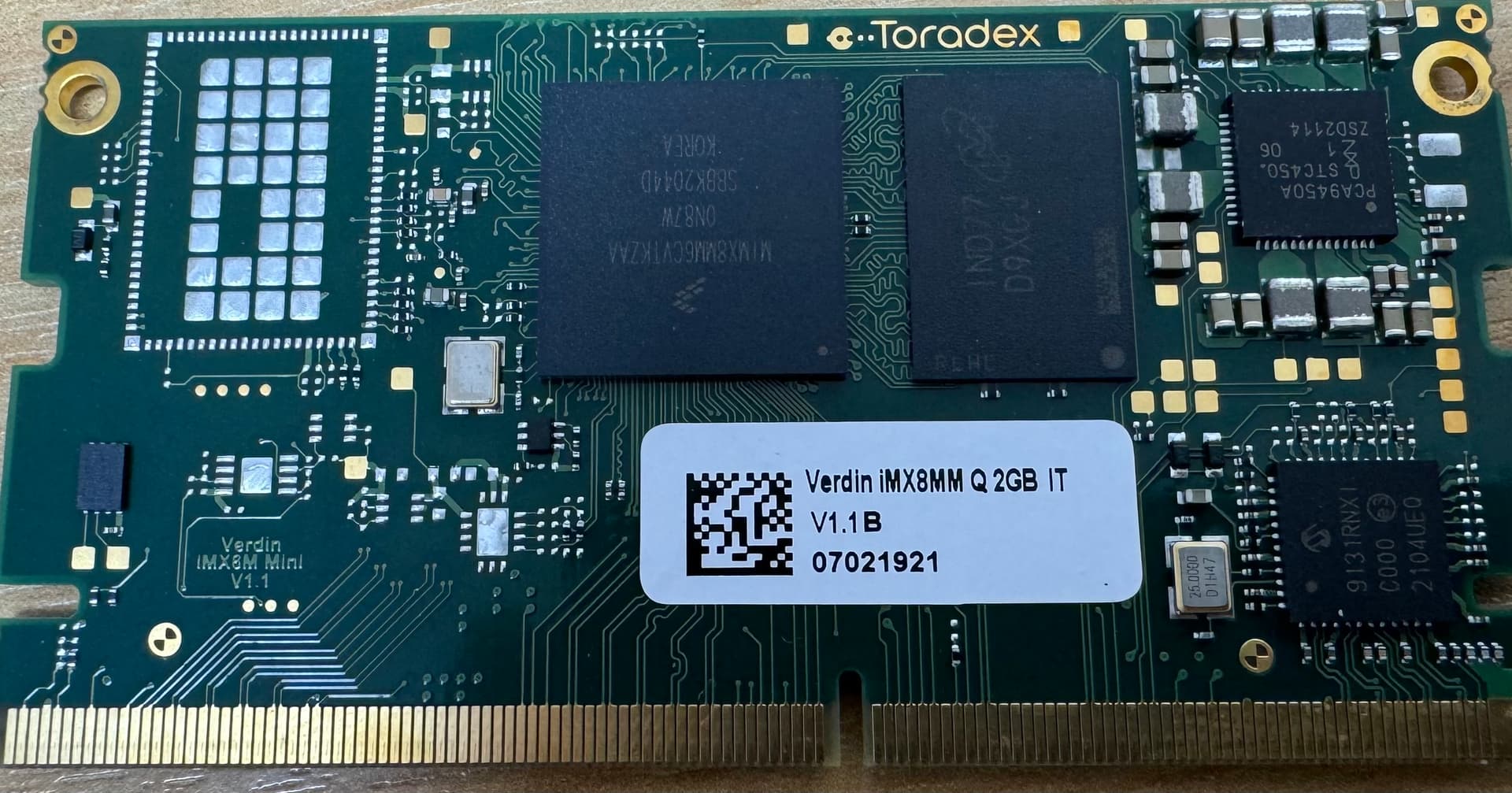

These are all 1.1b but probably supplied quite a while ago now. For example one of the parts with this issue is serial number 07021921. Are you able to look up what that was programmed with before it shipped to us?

We checked and on this particular older module ToradexEasyInstaller_2.0b7 had been preinstalled.
Please use the recovery mode to load and then flash the ToradexEasyInstaller_5.6.0 on it.
