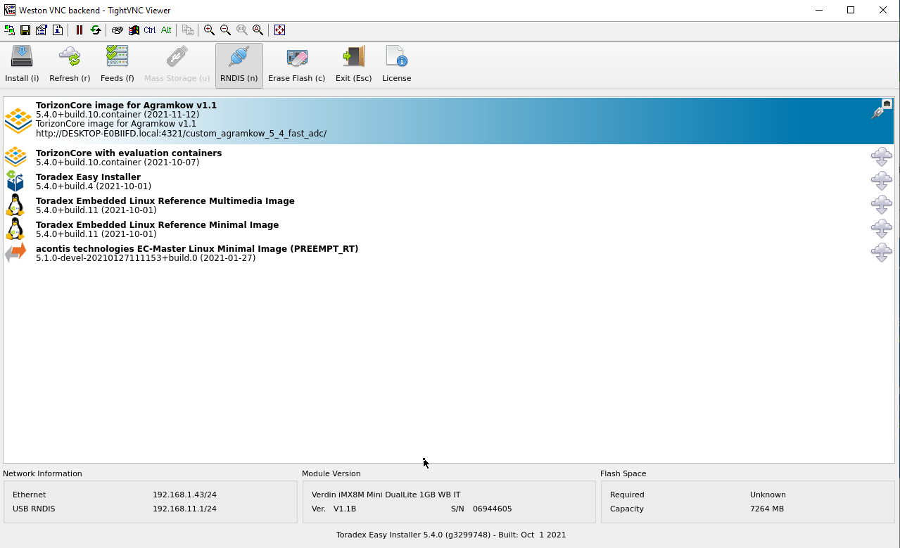

I am trying to get zeroconf working on windows …
Easy installer recognizes the service and can list the image available:

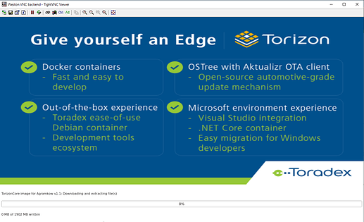

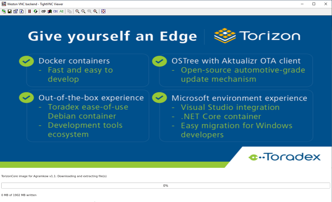

However, once it gets to the actual installation it is stuck at 0% …
