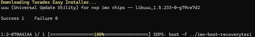

I’m using Windows host OS. There are no errors from recovery script. It just stops here:
But I tried the driver update from the link provided. After updating the driver it seems to work now.
Thanks, floji
