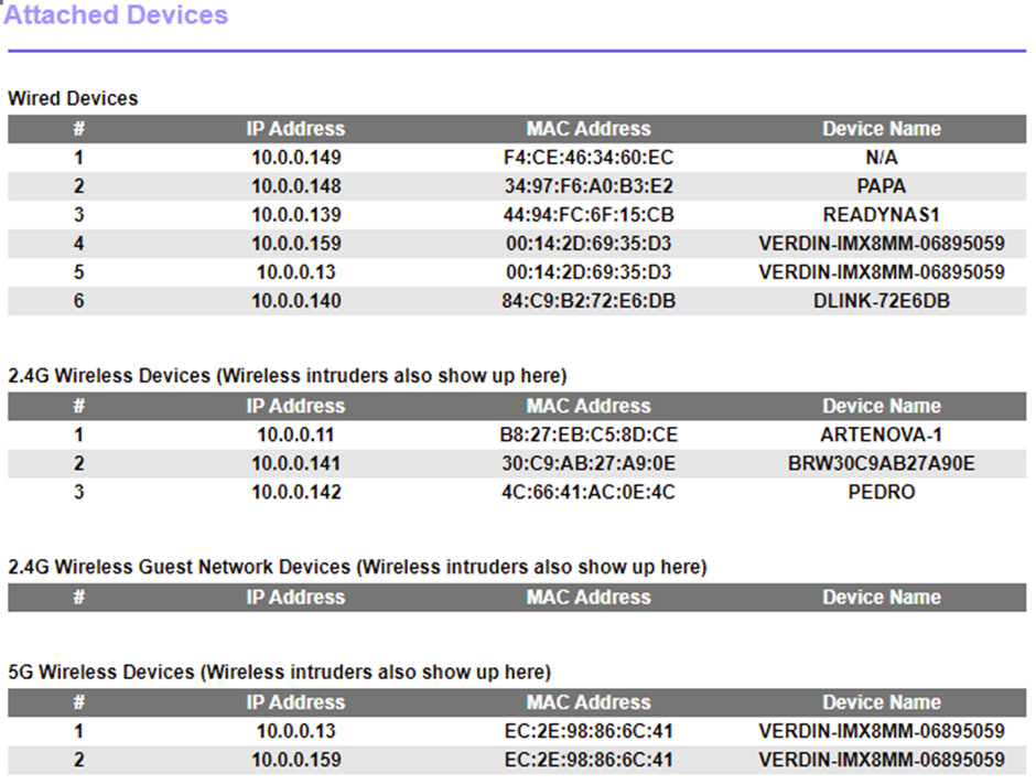

I am working on a Verdin project. I have enabled the WiFi connection on the module. I have configured my DHCP server to allocate a reserved fixed IP address to the Ethernet MAC address, but I have made no such reservation for the WiFi. Both the Ethernet and WiFi interfaces seem to be working fine.
However, I am getting warnings on my Windows development PC from my anti-virus software that there are duplicate IP addresses on the network.
Looking at my DHCP server, I see that it has:
  • Allocated two IP address to the Ethernet network using the MAC address as per the serial number of the module. One IP address is the reserved fixed one, and the other has been allocated from the free list.
  • Allocated the same two IP addresses to the WiFi network using a different MAC address (which I assume is the one in the WiFi component on the Verdin).
The following screen shot shows the DHCP allocations. 10.0.0.13 is the reserved address and 10.0.0.159 is the one allocated from the free list.
I have no idea why this is occurring, nor whether it is a problem with the Verdin module or the DHCP server. I have had no issues before with this DHCP server. It seems that after enabling the WiFi on the Verdin, it is somehow requesting two IP addresses on each network.
FWIW, it seems that I can only Ping the reserved IP address on the Ethernet network, and the freely allocated address on the WiFi network, not the other way around.
Any ideas on what might be causing this, and how to fix it?

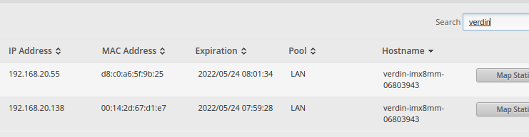

As you may see Device Name send from DHCP client to DHCP server is the same on LAN and WLAN. This is root of my guess that perhaps bug lets DHCP server to return IP of “the same device” ignoring real MAC. BTW how does it reserve IP? Does list of reserved IP’s specify MAC + IP, or indeed device name + IP? Please check that list.
I install Torizon 5.6.0 on Verdin iMX8M mini and connect WLAN and LAN to a Ubiquiti EdgeRouter X. But I don’t see two IPs assigned to the same LAN on Verdin iMX8M Mini. The two IPs are assigned to WLAN and LAN respectively. You can try with another DHCP server or router.
