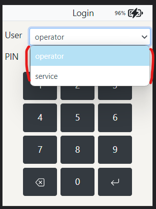

Hi, I built a GUI web app that has a login page using a dropdown menu for user name selection. It behaves normally in the desktop chrome browser as shown below:
However, when I deploy the image and test the web app on our device (colibri imx8 with a touch display), the dropdown list is not displayed when clicking the dropdown icon, but I can still select a different username by clicking on a similar location while not seeing the dropdown list.

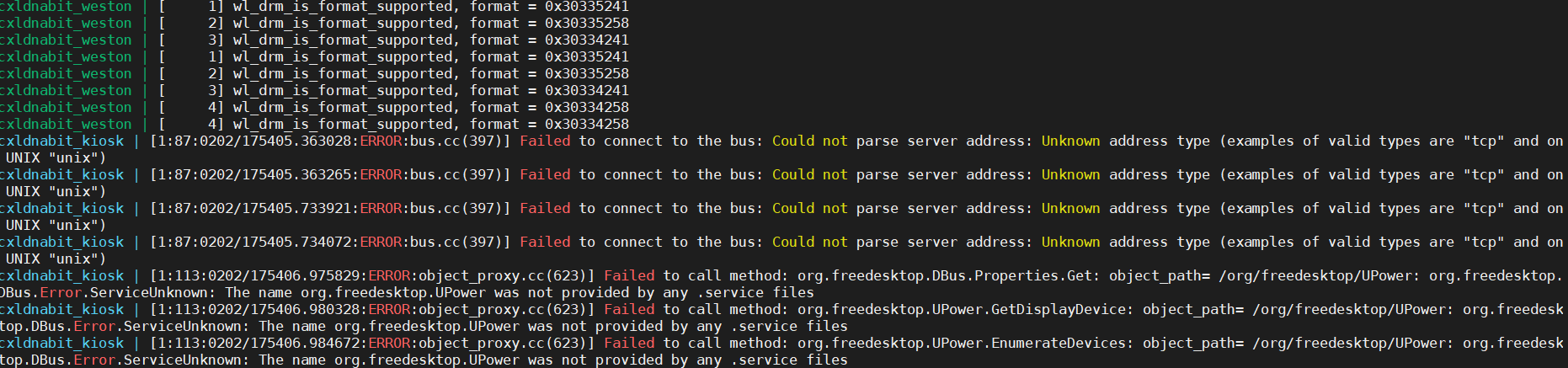

For the Chromium one, it through a “Could not parse server address: Unknown address type” Error and failed to load the web app, related docker container log showing below.
Actually those errors are normal and expected. When I point the torizon/chromium:2 container to https://www.toradex.com I see the following in the container logs:
[1:40:0202/185427.577982:ERROR:bus.cc(397)] Failed to connect to the bus: Could not parse server address: Unknown address type (examples of valid types are "tcp" and on UNIX "unix")
[1:40:0202/185427.578156:ERROR:bus.cc(397)] Failed to connect to the bus: Could not parse server address: Unknown address type (examples of valid types are "tcp" and on UNIX "unix")
[1:40:0202/185427.839204:ERROR:bus.cc(397)] Failed to connect to the bus: Could not parse server address: Unknown address type (examples of valid types are "tcp" and on UNIX "unix")
[1:40:0202/185427.841610:ERROR:bus.cc(397)] Failed to connect to the bus: Could not parse server address: Unknown address type (examples of valid types are "tcp" and on UNIX "unix")
[1:75:0202/185428.196567:ERROR:object_proxy.cc(623)] Failed to call method: org.freedesktop.DBus.Properties.Get: object_path= /org/freedesktop/UPower: org.freedesktop.DBus.Error.ServiceUnknown: The name org.freedesktop.UPower was not provided by any .service files
[1:75:0202/185428.202356:ERROR:object_proxy.cc(623)] Failed to call method: org.freedesktop.UPower.GetDisplayDevice: object_path= /org/freedesktop/UPower: org.freedesktop.DBus.Error.ServiceUnknown: The name org.freedesktop.UPower was not provided by any .service files
[1:75:0202/185428.207517:ERROR:object_proxy.cc(623)] Failed to call method: org.freedesktop.UPower.EnumerateDevices: object_path= /org/freedesktop/UPower: org.freedesktop.DBus.Error.ServiceUnknown: The name org.freedesktop.UPower was not provided by any .service files
[1:40:0202/185439.602769:ERROR:bus.cc(397)] Failed to connect to the bus: Could not parse server address: Unknown address type (examples of valid types are "tcp" and on UNIX "unix")
[1:40:0202/185439.602998:ERROR:bus.cc(397)] Failed to connect to the bus: Could not parse server address: Unknown address type (examples of valid types are "tcp" and on UNIX "unix")
[1:40:0202/185439.603097:ERROR:bus.cc(397)] Failed to connect to the bus: Could not parse server address: Unknown address type (examples of valid types are "tcp" and on UNIX "unix")
Despite these the website itself loads and works fine so I don’t believe these are problematic errors in anyway. That is to say I believe the issue here is probably something else.
