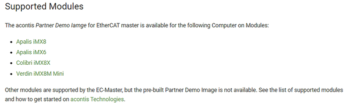

I choose the EtherCAT image.
When I hit “Mass Storage (u)” in the easy installer it will emulate several usb sticks and I dont know what they are there for. If I hit it again they disappear. I tried most of the buttons but it 'just doesnt want to see the image on the my USB stick (a physical one i put into the carrier board).
Can you help me?
We have the " High-End-HMI mit Wi-Fi-Starter-Kit" with:
  • Verdin iMX8M Plus Quad 4GB Wi-Fi / Bluetooth IT
  • Dahlia Carrier Board with HDMI Adapter
You can only install an image compatible with your module. And Acontis currently has no pre-built image for Verdin iMX8M Plus that you are using.
lease try an image built for the Verdin iMX8M Plus.
Thanks for the info diddnt see that. Now i tried directly with my own image as IMX8Plus doesnt have a lot of out of the box prebuilt images which seem to work.
Actually I did want to use a standard image because I was unsure if mine worked and therefore I first tried with the provided ones -.- what an ironie mine worked now directly…
